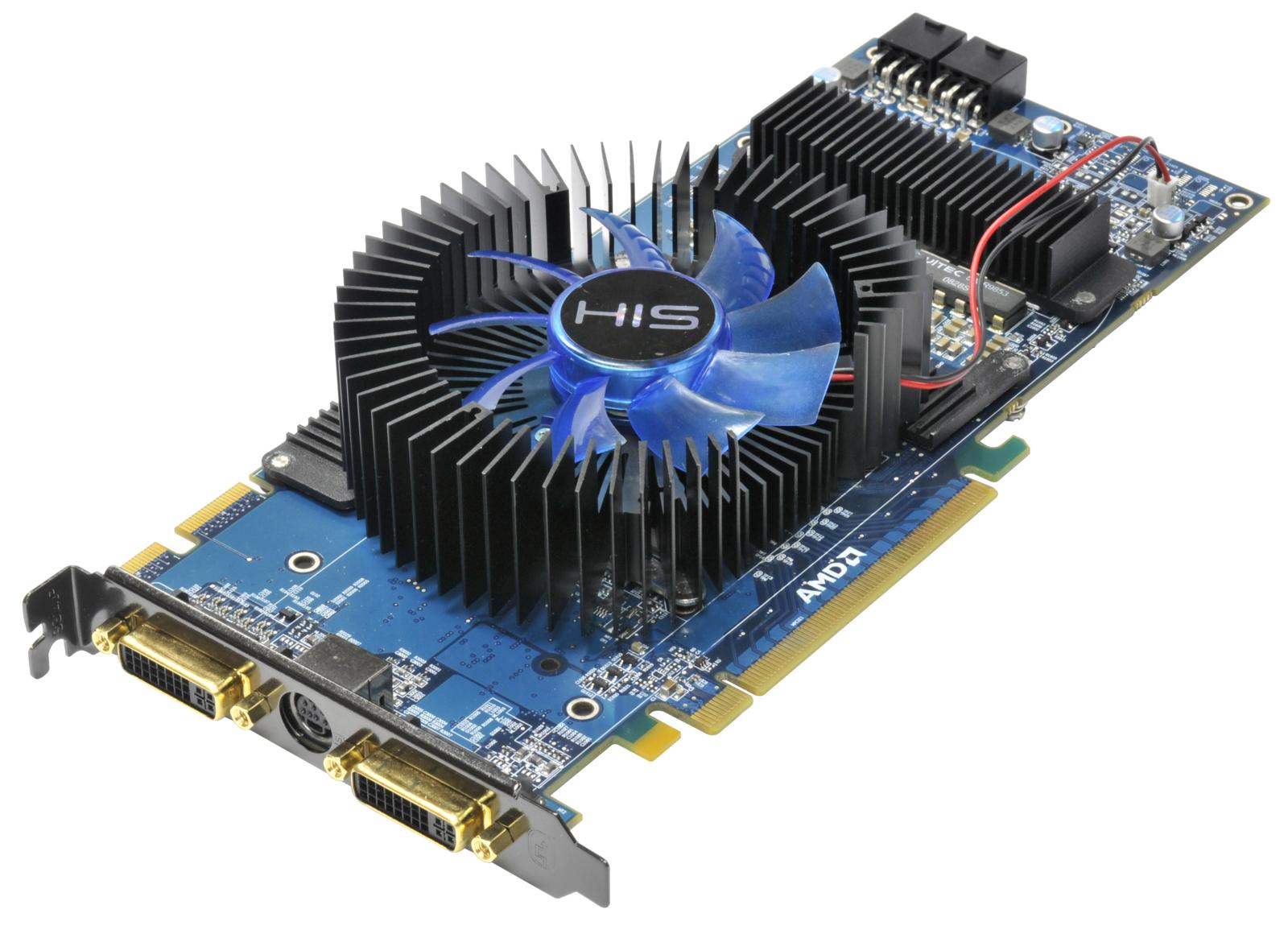

Just got my new HIS HD 4870 512MB today...badass card so far...atleast a step up, no a flight of stairs, from my old 9600GT...
Using current 9.2 drivers.
Anyways, I can't seem to get the damn thing to overclock...ATi Tool won't work (something about a missing driver), AMD GPU Tool won't allow me to change settings, and CCC Overdrive won't allow me to make any changes either.
I'm out of choices here guys! I know that heat is not an option, as the HIS card I got has a rather non-OEM cooler:
http://www.hisdigital.com/User...ct/4870_Fan_1_1600.jpg
Can't seem to post pics? Oh well, that link has the card in it...cools quite admirably with my temps never going over 75C running Crysis at 1680x1050 all Very High settings with 4xAA (13.44fps avg according to benchmark w00t...)

Actually..I had to click the little unlock key button...works now but only goes up to a paltry 790mhz...I know she has alot more in her.

Did you plug in both 6pin PCIe power connectors? If you don't, I don't believe any software will allow you to overclock.

Quite a few of the non-reference coolers do a poor job of cooling the VRMs, so you should keep an eye on the VDDC temperatures.

That's a little weird. Perhaps you should try a clean driver install after all. Even the CCC should be able to tell you that. It set mine at 50% by default, but they seem to noisy at that level and I reduced the speed to 40 and 45% respectively.
Good job with the OC, it certainly seems convenient to do it. I'll give it a try myself!
Nafets
440
No software will be able to detect the fan speed, as your card's cooler has only a 2-pin connector, with no RPM support...
