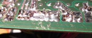

I just hope that crappy Logisys PSU didn't fry or damage two motherboards (and this review was on their retail products):
http://www.overclockers.com/logisys-ps480x2-review/
To summarize a bit, there are pros:
  • Cheap, really cheap.
  • Didn’t explode.
There are cons, too:
  • Regulation borderline.
  • Ripple control is horrid.
  • Cannot deliver 330 W, let alone the box’s 480 W.
  • Major solder ball issues.
  • Scary-thin wall plug cord.
  • Secondary rectifiers woefully undersized.
