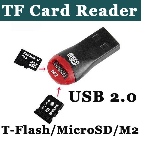

usb flash drives..does that mean that microsd usb adapters will work ?
I'm not really familiar with rooting Android. What are the drawbacks ? voids warranty ? makes automatic updates to OS a problem ? Lose installed apps or freebies that come with Nexus 7 ? Those kind of drawbacks I mean.
rooted means not warranty but u can unroot it and no one knows
it doesnt affect ota update, however update may unroot ur device and u have to root again
there is an app called nexus media importer that doesnt require u to root u can mount a external thumb drive or sd microsd card reader, im using it on both my galaxy nexus and nexus 7 without problem
