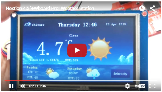

This is great stuff. Let say you want to build something but creating a graphics library on your own is a bit to much... No fear, Nextion is here. Nextion provides an lcd with resistive touch screen. The resistive touch screen can be a benefit in harsh environments.
And the lcd are cheap. Around 15 dollars for the 3.2 inch, i have been told.
The key is the Nextion editor, this program allows you to drag and drop graphic objects like buttons and animated graphics.
The lcd has a uart interface that allows you to control the armv7 based graphic controller or let it send commands to your mcu when you interact with the lcd.
For a demo :
