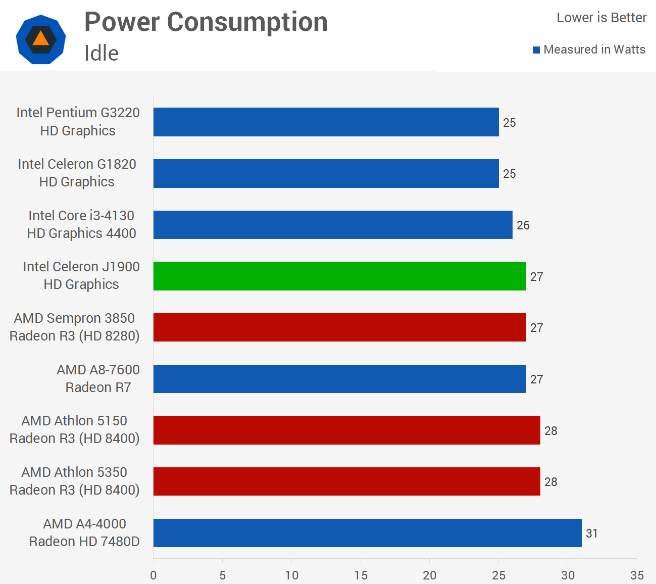

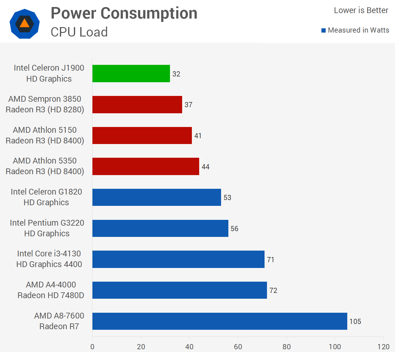

Price is not an advantage as it costs the same. As for power savings, they're negligible. Any of the two will be just fine on a small case as they produce very little heat. Have you seen the heatsinks even Core i7s come with? Maybe you'll save $1 on your electricity bill a year, but a Pentium is easily almost 2x faster.
Example:
And if you're gonna do encoding, hey, the Haswell Pentiums even come with QuickSync.
Power consumption isn't really much better on Kabini:
Again, negligible. There is close to zero reason to pick an Athlon 5350 when a Pentium G3220/3258/3440 can be had for the same price or very close.

This is a AMD kabini thread, why when every time someone mentions AMD some one has to start in with the you should buy intel BS.He already has this AMD system!!What do you people work for intel or something??Cause you sure push that crap enough.And as for an i3 being better then a 5350 I call BS all day long.. I can play most newer games on my 5350 at lower setting just fine getting an average of 25-30 FPS and trying to play the same games with a G3220 couldnt even get 5-10 FPS.
Also where are you getting these Bench graphs from cause under full load I am only seeing 20-25w peeking at 31w at the wall socket using my Kilowatt meter using a 5350 and 67-72w with my g3220.i3's and pentium's are only better when it comes to single threaded performance and thats all.If your getting 25w with your G3220 please share your magical settings cause I have never been able to get lower then 35w.
