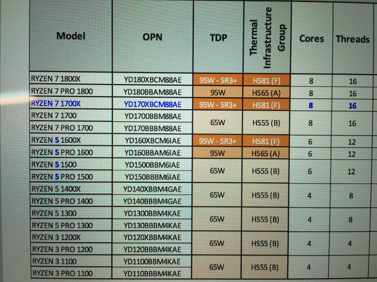

I'm still missing some information to decode final SKUs (TDP, Stepping, ...) : http://dzencoder.herokuapp.com/?code=YD180XBCM88AE
Some quick notes:
I think, "Y" is new (for "RYzen"). The 180 is for 1800. X is for "XFR" -> 1800X.
"AE" could still map to the stepping (likely B1 here).
For ES you can use this table: http://www.cpu-world.com/info/id/AMD-ES-identification.html and the pic made by a Redditor. Note the difference in first 3 digits, which denote base clock frequency/MACB, not just the first 2 digits.
Some quick notes:

I'm looking for some known Zen OPN codes to test my decode script.
For now I have those here:
ZD3601BAM88F4_40/36_Y
ZD3201BBM4KF4_34/32_Y
ZD3301BBM6IF4_37/33_Y
ZD3406BAM88F4_38/34_Y
If you have others, please post them here or PM me.
Thanks!
btw. The fourth number in the ES SKUs has nothing to do with the die configuration (as I speculated) or the revision (like PCGH claimed) 😉
Which also would suggest that my theory, that leaked 6 core CPU scores is NOT for 95W+ TDP CPU, and there will be one higher end CPU.
The 3.6/4.0 SKU doesn't have the 6, so probably not.
Gonna take a wild guess and say that the 6 indicates a PRO SKU.
BB - 65W, BA - 95W.
The 4C/8T model with XFR is Ryzen 5 1300. Which one do you think, the 3.6/4.0 GHz 8C/16T, with BA TDP target would end up? Yup. 1800 Pro. So it is entirely possible.
Also, bare in mind that WTFTech incorrectly suggests that 6C/12T is 95W TDP. Its not, as we can see from the indication of TDP target - 65W. So it is either Ryzen 5 1500 or 1500 Pro.

BB - 65W, BA - 95W.
My try:
Y = Ryzen (it's "F" for FX for example)
D = Desktop
180 = 1800, etc. (8350 with 4th digit for FX-8350)
0/B/X = std/Pro/XFR
BA/BB/BC = 95W HS65 / 65W HS55 / 95W + SR3+ HS81
Those differ depending on tray/memory package (MPK), this is for tray:
M = AM4 package (as with ES)?
4/6/8 = # cores
8/I/G/K = caches? threads? -> different for 4C/4T and 4C/8T
AE = stepping?
Tray vs MPK:
YD1700BBM88AE YD1700BBAEMPK
YD170XBCM88AE YD170XBCAEMPK
YD180XBCM88AE YD180XBCAEMPK
Edit: included The Stilt's remark and some info from this posting.
