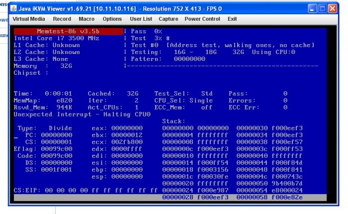

I think I also picked the wrong motherboard... it looks like this one has lot of issues. Damnit. That's always my luck with this stuff. :(
http://www.lucidpixels.com/blog/supermicrox9scm-fissues
It's also saying my ram is not ECC, when it actually is. It's also detecting the cpu as a core i7 and not a Xeon. It sounds like I may have a bigger issue than bad ram. What a pain. I wish I could build one single computer in my life time where there arn't tons of issues to deal with. For some time, I thought this was going to be it, because everything was going so smooth. But I judged too soon considering I had not tried any tests yet.

So the memtest with the latest memtest86 passed, so the issues I had may have been a false alarm. Though it still kinda bothers me that it crapped out like that, the older version worked fine before on other systems so not sure why it would suddenly not work.
