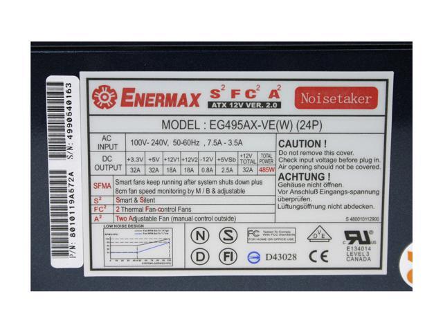

I bet you're right, that's probably the one. It has 18 amps on the 12V rail, which is where your high-end video card and your high-end CPU are pulling from. Label shot of Enermax showing that each of its two 12-volt rails can put out as much 12-volt amperage as your whole 420W Turbolink does.
So I'm almost ready to bet a cookie that some more high-quality 12-volt amperage would help. 😱 I know it's not easy to blow $120 on a boring rectangular thing with some wires coming out of it, but it's the foundation of the computer from an electrical standpoint.
BTW, you could go less than that in Enermax's lineup and still get a really healthy PSU. That one's claim to fame is partly that it covers the future needs of 24-pin ATX 2.2 and PCI Express, all in one. Here's a much less expensive alternative if you're content with one that works with what you've got now: link, $69 sound better? 29 amps on the two 12V rails combined.
