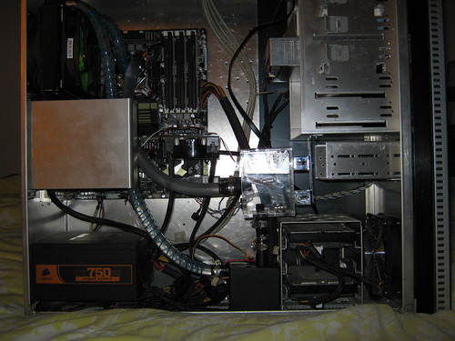

I opted for the swiftech microres. it's so much cheaper and it can be placed anywhere in the case. and I hung my pump off the bottom, I moved the lower port to the bottom and hooked up my pumps intake directly to it with a piece of tubing just long enough to cover the barbs.

Do you think I could get a picture of the loop? If you don't have one already don't worry about if you don't want to. Oh! I saw that botom port on that res, I like it can be used as a drain .

I can get one, I just need to commandeer my daughters camera.

that pump I got is a jingway dp-1200 that i got for $22 during crazypc.com going out of business sale. It's the same as the danger den DD-CPX-Pro
http://skinneelabs.com/jingway-pumps/
and the radiator is a temporary one until I decide on whether to get a 360 or 480 sr1. I can mount either in the top of my case, I'll just have to move the external ports if I go with a 480.

Oh! Okay, there is plenty room in the 700d for that. Ill have to get some extra lengths of tubing so I can run it farther.Only thing is, the GPU bock for the 6970 is out of stock. It'l be in stock by the time I order the things tho'
