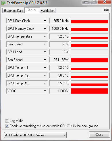

Gpu-z should show some vrm temperatures on the 5 series cards, keep an eye on them going that high on the voltage
I believe thats gpu-2 in the picture.
give us some screenshots people :)
