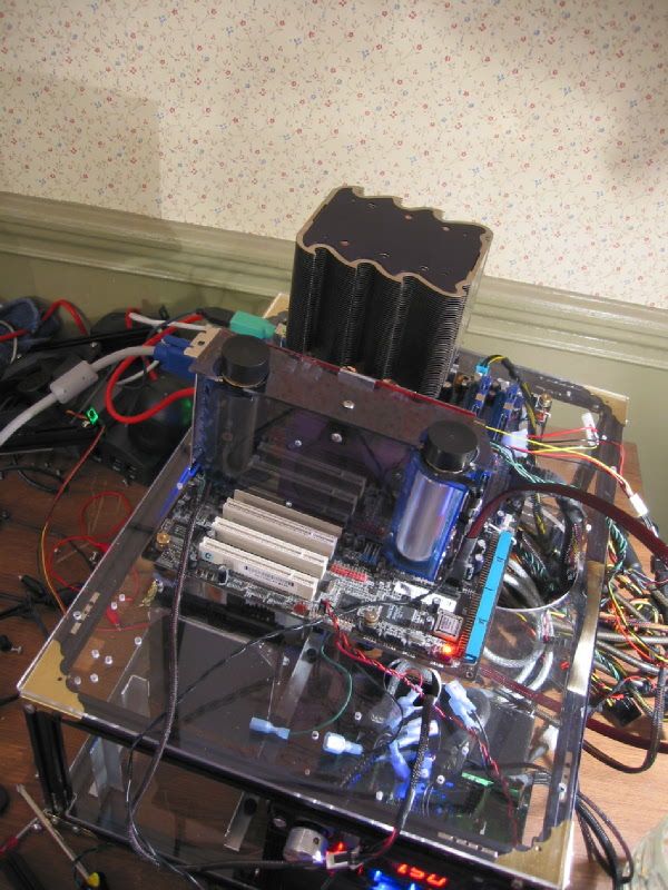

Have I mounted it in the wrong direction? See the picture here :
http://img184.imageshack.us/img184/8170/dsc0020dj4.jpg
Is my case fan system set up all wrong? I have a CM830, so the front fan in the 4x3 unit is intake, and the rear fan in the pic next to the CPU is exhaust. I added a 120mm on the top (exhaust) and I have 3 fans on the door (intake). The 4th can't fit because of the Tuniq. From what I understand, the tuniq's fan is both intake and exhaust together -- would the immediate proximity of the rear fan on the CM830 mess with temps this much? A lot of people have this setup, so I figured I'd have heard something about it.

OK yeah after some more research today I think I was confused by their marketing hype. I also believe that I do have the sucker mounted backwards as it definitely has an exhaust side and an intake side. According to the post at : http://forum.abit-usa.com/showthread.php?t=103462&page=1 and the subsequent picture http://img.photobucket.com/albums/v363/...XP120%20Ninja%20Tuniq/Tuniqonbench.jpg , it would seem to indicate that I have the Tuniq intaking from the same spot my 120mm rear fan is exhausting from. The picture, according to the author of that post, says that the Tuniq is intaking from the vid card area and exhausting topside. I have mine oriented the other way.
