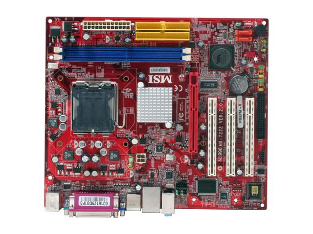

Im making a HTPC, and I have a microATX mobo. The mobo, ram, and CPU are all new, and when I put them all together, it wont even POST. It is an MSI PM8PM-V and intel Celeron D 331. When I push the power button, the fans spin, but nothing else happens. What could be wrong?

There is onboard video, but I also tried a couple of video cards (that I know work). I cant test any of it on another computer, because I dont have any other mobos or CPUs that are LGA775, or RAM that is DDRII SDRAM.

Both power connectors are plugged in. However, my PSU has a 20-pin connector, but the board has a 24-pin. I plugged the 20 into the 24, with 4 pins open. This is okay, right?

Yeah, that should work. Extra power-delivery wires would be helpful if it had some whopper add-in video card, but for your setup it ought to suffice.
You might run down my list of won't-POST troubleshooting brainstorms: http://www.mechbgon.com and it's the "Assorted reasons that your computer might not start or POST" document down the page halfway.

Okay, I read that troubleshooting rtf, and the possibilities are something broken, something isn't configured right, or the psu is too weak. Im pretty sure nothing is broken, since I bought everything online, and dont want to ship it. I just read the manual, and I dont see any configuration things, except the Clear CMOS, which is in the "save" position (just to be sure, I tried it in both positions). The only thing that leaves is the psu. I only have a 200w (came with the case). Is it possible that this isnt enough power for a celeron D, mobo, and ram? Thats all thats in the case right now. Thanks for all the help you've given so far.

200 watts might be a little on the skimpy side. Do you have any other computers you could borrow a 300W+ unit from to test with? Quality can matter, too... I'd take a 180W Fortron (a good brand) over a 300W trashy-quality one.

I have a power supply that I KNOW works. Its about 500w or so, should be enough. Its actually being used ATM, so Ill try it later.

Ahh, Im kinda embarrassed. I tried a 420w PSU, and it worked. Then for some reason, I looked at the little red voltage switch, and saw that it was set wrong on the 200w PSU the whole time. Oops. I would just stick the 420 in, but the case is small, and the 420 is about twice as big as the 200. Now I get a BIOS beep code. I can work it out from here, apparently my memory IS broken/wrong. Thanks for all your help.
