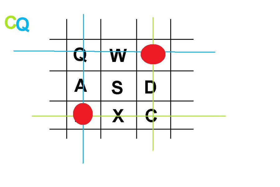

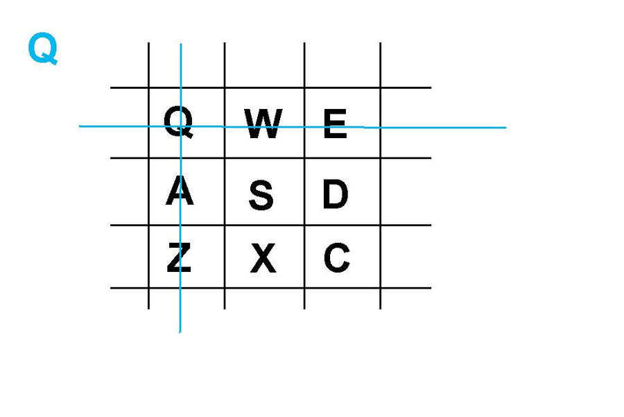

When you hit a key on your keyboard, you close a circuit. The circuit can be closed by the action of a collapsing rubber dome against a set of membranes, by action of a spring as it buckles catastrophically, as a pair of metal leaves pressing against a PCB, or even the discharge of a capacitive spring. However your keyboard is designed, you press a key and a circuit is closed. Specifically, two circuits are closed. These two circuits send a signal to your keyboard's controller, which looks at the circuits closed, then consults what's called a matrix (in the algebraic sense, not the Keanu Reeves sense). It uses the matrix to determine which key was pressed, then sends the code for that key to your computer.
Simple, right? What? No? YES IT IS TANJIT.
But it isn't always simple. What happens when you hit two keys simultaneously? When they're directly next to each other in the matrix, nothing happens. But if they're "diagonal"...
Here you've got the Q and the C, but there's a problem! The keyboard is also registering an E and a Z, because you've got intersections there. I'm going to ditch the regular terminology, because it's been corrupted and screwed up. This is called an ARTIFACT. Not a ghost. Got me? Good.
I am calling this type of key matrix a artifacting open matrix. It'll make sense in a minute.
Now, we can't have artifacts like that popping up. It'll cause problems while typing, and especially while gaming. So 99.999% of keyboards use BLOCKING to prevent this.
When you press C and Q, the keyboard's controller "blocks" all keys that could show up as artifacts. Thus only C and Q are sent, and not Z and E. But what if you *want* to hit Z and E?
You can't. You hold them down, but they don't register. They've been blocked.
I am dubbing this style of matrix a blocking matrix. This is the most common type of matrix found.
