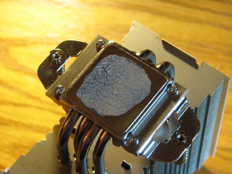

After doing some reading the following day someone mentioned using coffee filters as a substitute for a lint free cloth. Pulled everything apart and cleaned both surfaces again. But before I cleaned both surfaces I inspected how the grease spread out. It looks like I screwed up somewhere. I'm guessing what I thought was a small bead was still too much?
http://i100.photobucket.com/al...1/mcvickj/IMG_1692.jpg
http://i100.photobucket.com/al...1/mcvickj/IMG_1695.jpg

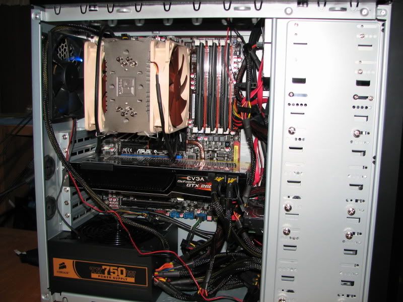

This time I decided to put a small line of Arctic Silver on the CPU and spread it out with the clean edge of a credit card. I've did this in the past with older CPU's and had good luck with it. During the installation of the HSF I also decided to install the second fan on the Noctua setting it up in a push / pull method and then exhausting out the rear case fan.
http://i100.photobucket.com/al...1/mcvickj/IMG_1697.jpg
Fired the system back up and walked away for a few minutes to let it warm up. ASUS PC Probe II is reporting a solid 40C at idle. GAH!!!
Thoughts? Suggestions? Tips?

I would use the latest version of CoreTemp (0.99.5.20 Beta 64Bit) to monitor CPU temps. If you use a 32Bit OS (unlikely if you are running 6GB of RAM), then use 32Bit CoreTemp.
Also, the two photgraphs that you show of the CPU and HSF with the TIM applied, look okay to me. The TIM has spread throughout the surface of the HSF and CPU IHS.
I've had a look at the product spec for the Noctua NH-U12P SE1366 and it has two fans mounted on it. Two things to look at:
1. Make sure that the fans on the HSF point in the same direction in a push-pull config. i.e. the air flow should look like this: HSF fan 2 <--- HSF <--- HSF fan 1.
Fans usually have directional arrows stamped on the housing to show the direction of rotation and direction of air flow.
2. Make sure that the HSF and rear case fan are orientated correctly so that the air flow looks like this:
Rear case (exhaust) fan <--- HSF fan 2 <--- HSF <--- HSF fan 1
The whole point is that the air passes through the HSF from the front (i.e. HSF fan 1 pushes the air into the HSF and HSF fan 2 pulls the air out of the HSF; hence push-pull config), then the fan in the rear of the case exhausts the hot air from the HSF.

The ambient temperature in my room is around 23C. I have tripled checked that the fans are in the correct orientation as described by daw123. I pulled everything apart this morning and used the cleaning cloth I picked up yesterday. I felt it did a much better job prepping the surfaces. As I type this my temp of my CPU is 35C as reported by PC Probe II. I'll give the AS5 a chance to heat cycle a few times but I think I got it this time.
daw123 - You are correct. I am running Vista 64. I'll give CoreTemp a look. Vista keeps squawking about PC Probe II on boot about being an unidentified program wanting to access my computer. I haven't had a chance to look into this error yet.
