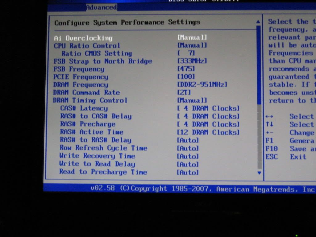

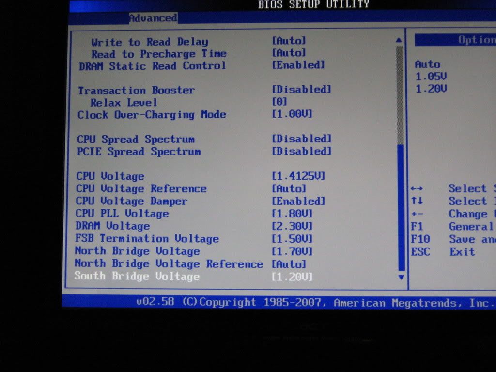

You have a similar setup to me, here's a couple of pics of my "Jumperfree Configuration" BIOS screens that might help.
Top half:camera:
Bottom half:camera:
To get your E6400 over 3.2ghz you will likely need to get the voltage up to 1.37 or higher. Your CPU is safe up to 70C under load, but it would be preferable to keep it closer to 60C. My temps are ~40C idle and ~60C under load.
