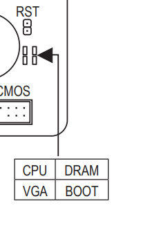

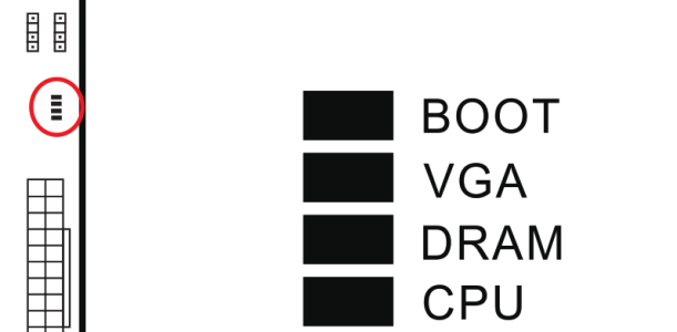

Some of these MOBOs default to the HDMI port and don't pick up the GPU card for output. The red light should have some writing next to it to tell you WTF it's whining about. At least mine does.
DL the manual and put it on your phone to help you through the diagnostics process.

Here's what your lights mean.

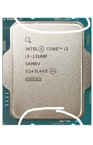

OMG I feel like the biggest idiot EVER! I had the CPU installed backwards! I'm posting from the new machine now! I didn't even have to install drivers, it just automatically had me download a Gigabyte utility that did it all for me. Easiest install ever. Same windows install as my old machine, switchover smooth as glass!

Really feel silly. Didn't even know a CPU could be installed backwards. Glad it didn't damage anything.

That should not be physically possible. There are notches on the CPU that are supposed to prevent that from happening. As you can see below they are offset so that the CPU must go in only one way. You must have had to really crank down on the ILM to get it to latch.
That's how I figured out it was backwards. It was clearer at a glance on other intel builds I've done.
