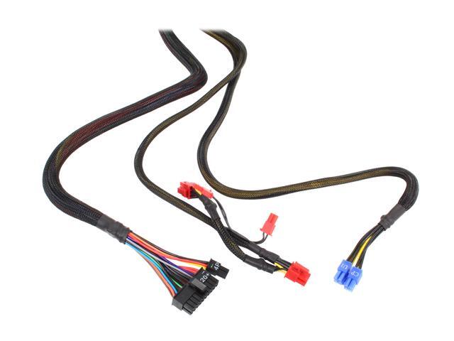

Additionally:
My 8 pin plug is divided into 2 parts, each with 4 pins. They don't fit together into a single plug. You attach them separately or just use one.
One of them fits fine into the right side of the motherboard port, as expected. This is with the clip on the plug facing the top of the case. This 4 pin is labeled UL1. This covers pins 1 and 5, which the manual says is a requirement.
The other 4 pin is labeled "CP" (whatever that means).
But there's a problem with it. I'd assume it would also connect with it's clip facing the top of the case. I exerted a lot of force on it, but it would not go into the connector when oriented so that the clip faces the top of the case.
Yes, they do. That's the whole point of the 8-pin (4+4) EPS12V connector arrangement.
Edit: Some PSU have both a fixed EPS12V 8-pin 12V power plug, and a 4-pin ATX12V 12V power plug hanging off of that one. If that's the case, use the plug appropriate for the mobo in question.
They all come like that on all the power supplies I've used. They will fit. Your power supply says it comes with 8 pin 12v (2 x 4) and states it's Haswell compatible.

Larry:
You can put the 2 parts right next to each other and try to manipulate them as if they were linked or locked together, but they don't connect to each other to form a single unit.
Each has a separate clip and that's the problem. If you orient both clips to 12 oclock, no go---only the right half says OK.
If my magnifying glass is to be believed, the left half wants a 9 oclock left facing clip.
Which may be true, but it's unusual in my experience. Never seen it.
May work, but I'm spooked.

OK. I am trying to keep my blood pressure down right now, and I will provide one last answer for you. Either try it or don't. You can RMA it if you want to.
Your motherboard needs both of those 12v connections installed. This is a picture of your cables on your power supply.
http://images10.newegg.com/NeweggImage/productimage/17-182-169-07.jpg
Do you see both of those blue connections? When together they spell 'CPU1'. Push both of them together and install BOTH of them in your 12v connection. They will both fit. They both have a clip on one side. That side will match the socket where one side will have a little 'ramp' on one side to catch them.
If you can't figure it out, Google 'Install 12v connections motherboard' and watch a videos on Youtube.
