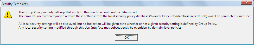

I've (sort of) fixed my problem by resetting my group policy to defaults using the following on run: secedit /configure /db reset /cfg "c:\windows\security\templates\setup security.inf" /overwrite
It -seems- to work perfectly fine now, considering other computers can actually access my shared folders now..
