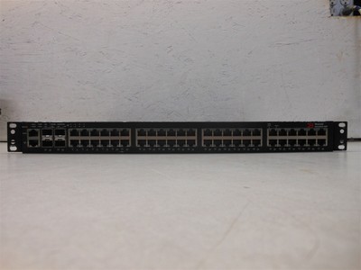

Personally at $200 for that switch, I would go the used market and get a Brocade/Rukus ICX6450 similar to this:
That will only cost you $140 or so shipped. Additional benefit is it is a fully managed layer 3 switch with 4xSFP+ 10GbE ports as well. But do some research, there is a HUGE thread on these switches over on serve the home:

I wanted to chime in a little more about the brocade since I was the one to bring them up in the first place. It will take some research/learning on how to properly configure them if you have not previously configured an enterprise switch like a CISCO. There are a bunch of youtube videos on many of the features and how to do it, and on the website I linked there is an excellent tutorial on how to first configure the switch going through updating it's firmware to the latest, setting proper passwords and initial security settings so that it is ready for actual use.
I personally have a ICX6610, which is much more than what you need, and is about 2x more expensive. The 6610 is also a 40GbE capable platform (which is why I bought it), but it most definitely is considered on the loud side (there are some recent hacks in quieting them, but the other switches like the 6450 are more compatible for having their fans modified/replaced with quieter ones available on the market and are much quieter in general). The 6610 also has redundant hot-swap fan modules and power-supplies which was another reason I went for it since I was going to use it as my network core switch, not just an edge switch for a specific use. Now I can say that the 6610 has a web based interface available that can be useful for people who are not accustomed to enterprise grade switches, which can let poke around a lot easier for features and capabilities than using the command line. I am not certain the 6450 has this capability, but for just creating some basic VLANs and setting up some access control lists to determine what traffic can communicate to the VLAN you designate for your security cams, you should be able to follow several tutorials and examples that are out there even for command line.
But again, do some research on them, watch some of the youtube videos. These switches won't be for everyone due to them being actual enterprise grade with enterprise level configuration/managment. Take some time to read the datasheet/FAQ on the 6450 switch line-up as there are probably a dozen models and you want to make sure you get what fits your needs and verify that the PoE capabilities will meet your requirements. If you are simply going to use it as the edge switch in the garage, and the only network devices connected to it will be these security cams, you can probably look at the 24 port switch (which will also draw a little less power).
What's funny I guess I bought one of the nice 200$ 10gb poe brocade switch. But it's still sitting in the box never opened it, didn't feel like spending all day setting it up and continue to use my netgear dumb switches that have been working great with regular router and few rules / vlans.

I think the 24 port versions with PoE end with “-24P”. I think there are also ones with an “F” in the end which changes the direction of the cooling fans (I think meaning “Front” exhaust, but best to double check that). My 6610 is front exhaust as I knew I was putting it in my mini rack and cable management wise it made more sense to have the majority of the ports on the back of the rack where all my other network connections would be coming from instead of running the wires out to the front of the rack. Just make sure you pickup one with a “P” as that is for the PoE capability (not the end of the world if you do not, but you then need to find the PoE board on its own and then install it yourself, which would probably cost more than just getting the correct one from the beginning). Make sure the buyer you purchase from is offering a guaranteed working with like a 30 or 90 day replacement/refund plan (this stuff is used, and they don’t always check that everything is really working because it takes more time than it is worth).
It doesn’t take all day to setup, just 30-45 minutes to do the basic wipe/update to latest firmware/set passwords. You can load either a switch only (layer 2), or router (layer 3) firmware on most of these if you simply want to use as a managed switch with basic VLAN capability. But seriously I would run the full layer 3 code base and spend the extra time configuring it.
You will need a proper cable in most cases to do the initial setup, but that changes depending on the model you get. Mine worked with a standard usb->com port cable I already had around. Might cost $10 or so if you don’t have one (but most people who have worked on enterprise hardware already have these laying around).
