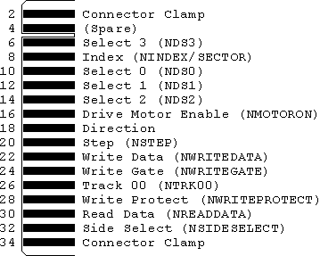

Don't insert a disk into an old floppy drive without first inspecting it for dust because it's rather easy for a single piece of dust to scratch the magnetic coating and render the disk unreadable. Heads can be cleaned with alcohol and a q-tip. The heads are typically moved by a steel band, which runs with no lubrication and tends to be maintenance-free, but many old drives used either a lead screw positioner or a plastic disk with a spiral guide groove, and too much dust or old hardened grease can cause poor head alignment.
Place black electrical tape over the 1/4" notch on the side of the disk jacket, to prevent the disk from being written over. It is very easy to accidentally overwrite a disk by plugging the controller ribbon cable backwards, and you cannot trust any connector key to prevent this. The tape must be black and opaque because the write-protect sensor is usually an infrared optical device that will not work with any kind of transparent or even translucent tape, as 3M learned when it had to issue a recall for some 5.25" floppy disks.
5.25" drives often have a removable termination resistor pack that must be installed or else the computer will not be able to communicate with the drive. Only one terminator pack must be installed per ribbon the cable, except in the case of some newer (mid 1980s) 5.25" drives with high resistance terminators (usually soldered in place).
Perhaps most 5.25" drives support both 1.2M and 360K formats, and they tend to have many jumper settings. There are settings for the drive number (select for second drive, meaning #1 if the numbering is 0-3, or #2 if it's 1-4), Drive Select signal (either by Select signal or Motor_On signal), RPM (360 or 300 -- doesn't matter for just reading disks), and pin 34, which may be set to indicate Ready status, Disk Changed status, or left unused. Choose DC since Ready causes errors. 360K drives don't use pin 34, but not using it can make DOS fail to detect when a new disk is inserted (read up on the CONFIG.SYS command DRIVPARM and its '/C' parameter, or just hit CTRL-C to tell DOS that the disk has been changed).
Actually no floppy drive function unless that function is been asked.
Floppy drives has a cut in the side off the connector. Floppy data ribbon has plastic notch which makes it is go one way only.
Data Ribbon also have notch on controller side of connector, which allow to go one way. Some time floppy controller does not have that have orientation correction connector. If that is the case floppy drive activity light will lid up and floppy drive become unusable. It will not start erasing.
The floppy disk interface is not like IDE or USB, where command words are sent, but instead control lines are merely pulled low to select the drive, turn on the motor, move the heads, or write data. The 34-pin connector has signals on one side (even wires) and grounds on the other side (odd wires), so turning the connector around will ground the signals that select the drive and write data, meaning the drive will try to erase the disk. The notch in the edge connector and key in the ribbon connector should make this impossible, but in practice many ribbon connectors are not keyed. The drive light will constantly glow when the connector is backward, but that hasn't stopped many people (mostly in management) from inserting a disk anyway. Black tape over the write-protect notch will prevent this accident.
Actually once ribbon is connected backward drive is not usable. OS cannot even do seek or goto track Zero read sector per track to write.
In order to write it has to do read the track Zero, where disk has sector per disk information; then it can write.
All the 5¼ drives and Data Cable I have seen they all have notch. Only matter is on controller end where its common it may not have plastic sounding shroud cover for the pins (Very unlikely).
5¼ have a better data chances of keeping the data then 3½ cause 3½ have very high density and chances for track go bad quiet often.
Here are connectors from two floppy drive cables, one with no key on the edge connector, another with no key for the pin connector:
In order to write to the floppy disk, the drive only has to be selected and its Write gate enabled, and I have seen people accidentally erase disks when the drive cable was plugged in backward. Some 5¼ drives automatically move the heads out when a disk is removed or inserted, putting them in the worst location if the cable was backward, track 0.
People can usually align the heads of 5¼ without an oscilloscope or alignment disk, but rarely can they do that for a 3½.
