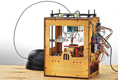

I have some laser cut plywood. I want to put some kind of finish on it to protect the wood. I was considering painting it, but the plywood also has some laser etched text and markings that I want to preserve.
So I'd guess I'd like to stain it. Are there any tricks for staining plywood?

The material is high quality 1/4" birch plywood.
The project is a tabletop 3d printer. The parts all came in a kit and are mix of laser cut plywood and acrylic.

Well, I am curious in giving the wood some more definition. The parts are good quality plywood (no knots, good uniform surface) so I think I can get a decent stain.
My previous experiment with staining cheap pine plywood was that the stain did not apply uniformly. It looked kinda crummy. I'm hoping this better birch will stain better.

Hmm... perhaps. I am afraid of ruining the wood with the stain and I was only wanting to give it a very light oak stain anyway. Maybe I will only do the poly then...
Is it better too use spray or brush it on myself?
