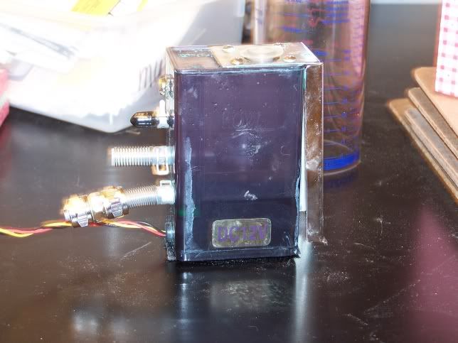

I'm no expert...but I would not be mixing different tube sizes as it will affect flows and cooling. Trust me...if you decide to move on to a different higher end pump you are more than likely going to need to upgrade a lot more. ..I'm a perfect example of that ...lol I had the Thermaltake BigWater Kit and the only piece I have left that I'm using is the radiator

Hmm, yes... that looks like the older Aquarius II type pump because of the springs inside the tubing. Either way it's worth a shot and I appreciate the offer to help... by the way whats with the top nozzle there? I will have to get with you tomorrow about working out a deal for the used pump.

Top nozzle...I think you are talking about the one that has the black cap on it?, not sure, I think its for a bleed line...but I never used it because I never had to...not sure it's older than yours though because the kit I got also came with a small fill reservoir...and the reservoir has the markings on it similar to your pump ( I think thats why I jumped to conclusion we had same pump). I never used the reservoir because this pump had plenty of fill space in it. one last thing...I took the photo real quick like and really didn't notice how dirty the pump was...It will definetely be cleaned up if you buy it. ..by the way, the springs are on the outside of the tubing not on the inside...
OK...one more thing...I think the pump is the same exact pump you have. It's definetely not the Aquarius II. After looking on the net...it is the same pump as yours...mine just doesn't have the markings on it and the top hole has been plugged...so, there are 4 total inlet/outlet holes...but like your setup I only used 2.
