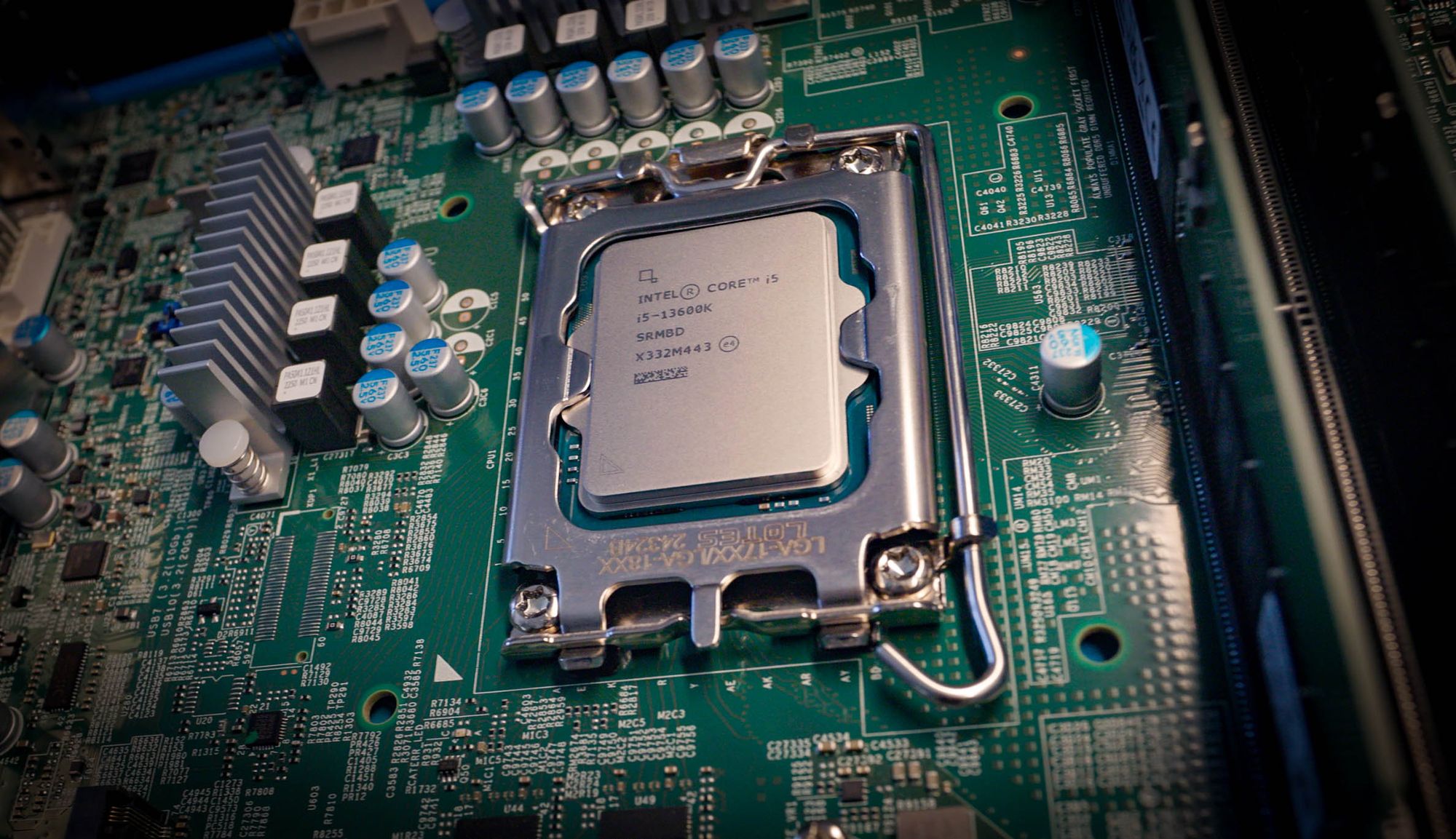

That said, your dual xeon is going to use a lot of electricity to do its job. I found this recent article in my feed:
The main point is that Intel Quick Sync on a modern processor is very much more efficient than your two CPUs. I'm guessing you can't afford a very modern CPU. So you could look up the video codec(s) you're transcoding from here and pick an appropriate used system.
