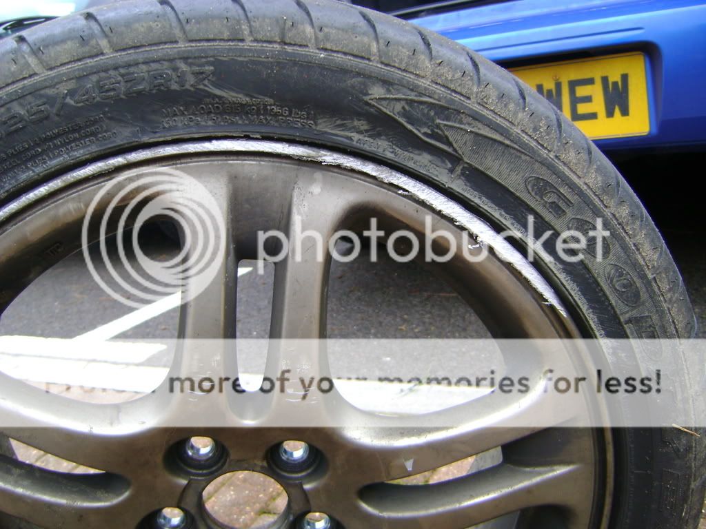

btw you're lucky you didn't buckle the alloy (the standard Subaru wheels are made from a very soft alloy). This is was happened to me when I hit some black ice back in December going around a corner (at about 10-15mph) and kerbed the car. Ended up replacing all the alloys for second hand ones (which was cheaper than buying one new replacement alloy from Subaru). All in all it cost me £300 for having the four tyres swapped to the new alloys, tyres balanced, new valves and laser alignment to the front and rear. Thankfully the wall on the tyre which was on the buckled alloy was not damaged (I got the tyre fitter to check).

I've got aftermarket wheels. There's some decent scratches on the wheels but nothing close to that bad. How much is "too much" buckling?

You will know it as soon as you drive the car (as I did). The steering wheel will vibrate and it will get worse the faster you go. Also if the wheel is buckled, the tyre fitter won't be able to balance the wheel.
You're lucky that you are running aftermarket alloys otherwise you would likely have one buckled alloy on your hands (it really doesn't take much to buckle the standard Subaru alloys). Running on the space saver spare is a pita; you're restricted to 50mph.
