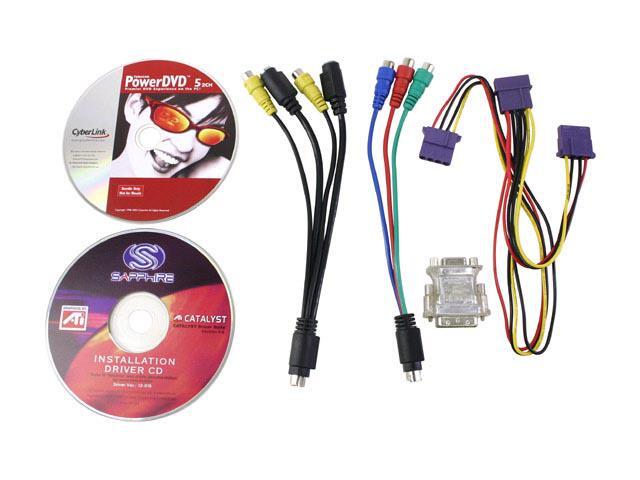

As far as the "S-Video" output on your card. Thats not an s-video connector. ITs a custom connection that you plug an adapter into. you should have gotten a bunch of adapter cables with that card. One of those adapter cables will have svideo. But use Component signal for HD if you cant get the dvi working
Sample of adapter cables:
http://images10.newegg.com/pro...mage/14-102-423-04.JPG
As far as the DVI not working. My GUESS is that it is not enabled. Go to your display properties and make sure that its enabled and that XP 'sees' 2 connections. IF you have an lcd with DVI input, use it to test the connection.
