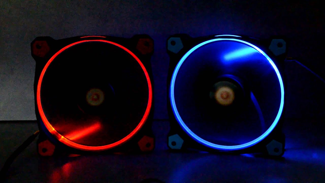

As for the 140mm fans that have no major obstructions, or does not require a lot of static, meaning things blocking it, i would go with thermaltake Rings 140mm.
https://www.amazon.com/Thermaltake-...0335102&sr=8-5&keywords=thermaltake+140mm+fan
2 for 30 dollars is a very good deal on those fans... so it would come out to 60 dollars for 4, not to mention they look awesome because its not the entire fan that is a LED, but the ring, like how a BMW daylight lights are.
