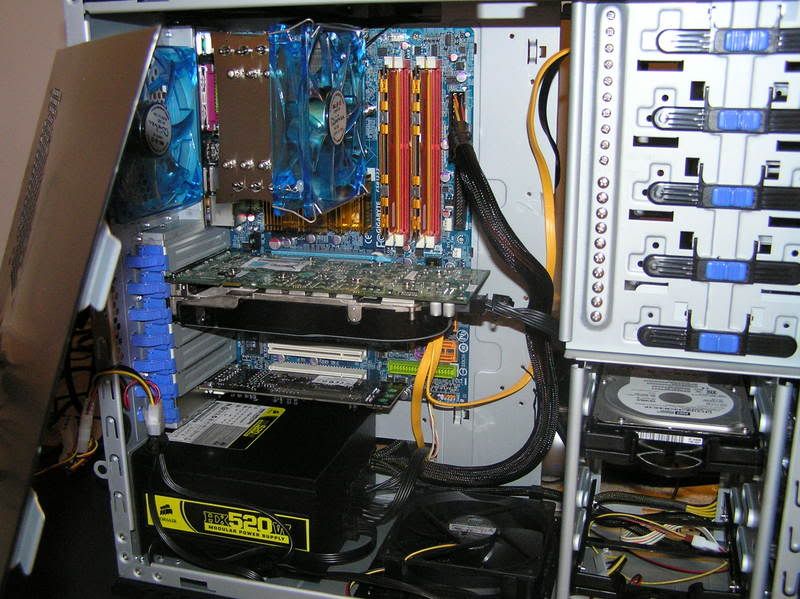

So since I got a few new components I decided it was time to clean up my case and maybe optimize my fan placement. I made an AWESOME drawing of what I was thinking in powerpoint. 1a in 3/4 view and 1b, 2 looking straight at the motherboard tray. The CPU cooler is depicted like an EM wave! The arrow is pointing straight at you...
So basically, I was trying to work with the 3 stock fans that come with the case. My processor the E7400 has the stock Intel cooler and my PS will be the HX520.
- 1a and 1b is how I'm thinking of setting it up with outside air coming in from the back and bottom to push any hot air removed from the cpu cooler through the top exhaust. My current gpu is fanless but I will probably be replacing that soon and will need to factor that fan in as well.
- Configuration 2 is something completely different that I was thinking of trying with a fan sitting in the optical drive cage at an angle towards the CPU cooler and the NB with the exhaust in the back.
Issues:
- It remains to be seen in either case whether the bottom fan can pull an adequate amount of COOL air from the bottom of the case, only an inch above my desk and through a filter. When I had a fan in the front of the case, within a few months almost no air was going through because the front filter was completely clogged.
- How should I mount the PSU? I believe the fan is blowing air out of the unit so I guess it would be better to place it with the fan facing downwards since there is a place for it to exhaust as opposed to warm air blowing onto my graphics card.
- When I replace the graphics card, if the fan blows air downwards, it won't really go anywhere except onto the PSU. I have been thinking of a 4850 or 4870 for what its worth.
I am thinking of ordering some 140mm fans that will hopefully be quieter but I want to figure out placement first to minimize noise and maximize cooling.
I am going to finish installing things tonight and see how everything works.
Any comments or suggestions? How is your 690 or other case setup?
