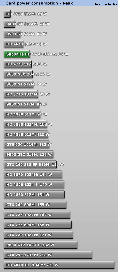

edit: I'm gonna tell you a secret, a 5750 uses less power than a 9800gt and is much faster.
I would grab a 5750 or a 6750, they are the same and they only use about 70 watts.

Your pci-e slot give 75 watts and the 5750/6750 uses about 70 watts, the extra power connector is just a precaution. I have seen them with just a single molex connector for extra power.
The molex to pci-e connector comes with the card and the card will run off of that 300 watt power supply with the low power cpu that he's running.
I do not recommend the 5770/6770 and the 9800gt (EE) uses the same power as the 5750/6750.
The card I linked will work easily with his psu, with no overclocking.
