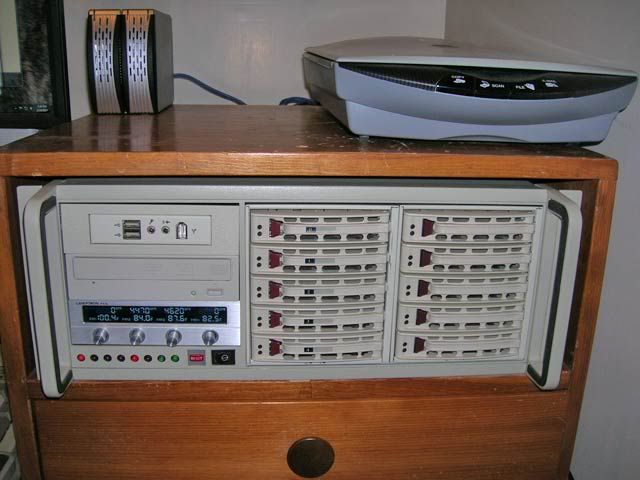

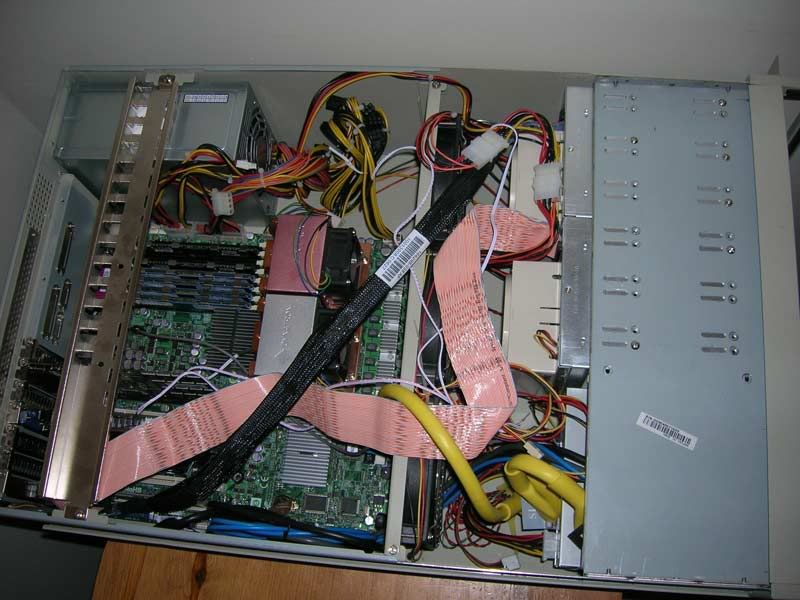

What case do you have?
4U general tech
http://www.gtweb.net/products/p1967/J4120-IPC-Case-4U-12-Bay-ATX-Deep-Beige
http://i1066.photobucket.com/albums/u414/turtle-web/computers/workstation3.jpg
http://i1066.photobucket.com/albums/u414/turtle-web/computers/workstation1.jpg
