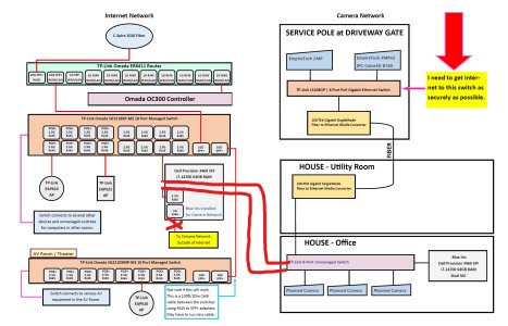

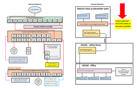

I originally thought we would be able to keep our camera network separate from our home Internet network, but as it turns out, the non-Internet methods of controlling our gate are not our best and most reliable options. We will need MyQ, which will require Internet to the switch on the service pole at our gate. Below is a diagram of the network. What will be the most secure method of getting Internet to that switch? Many thanks!

When you say securely, what do you mean?
Are you trying to keep the camera network 100% isolated from the main network AND provide the camera network internet access?
If so, VLAN’s are the answer

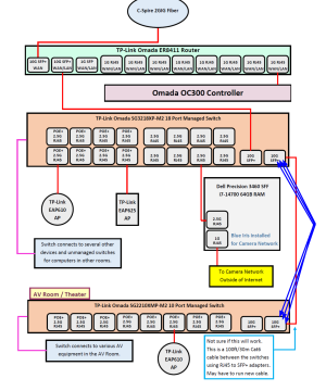

I got my AV/Theater Room switch connected a while ago with the 10G SFP+ connection. It worked for about a minute, and then the entire network went out. I could not even access my Omada OC300 Controller or the Router. I disconnected it and was able to get into the controller long enough to see a log entry with an error: TP-Link Omada SG3218XP-M2 port Te1/0/18 was blocked.
The network has become very sluggish. It appears I have something working because I'm getting on the Internet, but I am no longer able to log into the controller or the 8411 router (which I normally control it with the OC300 controller anyway, but at least can get to the login screen).
Any ideas on what's happening?

I'm definitely not a networking guy, but for some reason that SFP+ port (which is port 18) got blocked. When it happened, it knocked out the network.
The network as stabilized, but I have not reconnected that AV room switch... not sure what it's being blocked.

Originally, I had an unmanaged switch in the AV room connected with an Ethernet cable, and it was not getting an IP address. I also had the AP connected to that switch for better WiFi in the AV room. It was all working fine.
Then... I swapped out the unmanaged switch with a managed switch that has a 10G SPF+ connection so that I can get better speeds out there. None of the switches have WiFi... only the APs I have connected to them.
When I swapped out the switches, that is when the SPF+ port on our main switch (the 16-port switch feeding the AV room switch) got blocked.
I removed the AP from the AV room switch, and the SPF+ port was unblocked. It is working fine now but without the better WiFi in the AV room. I still have WiFi, just not quite as good as it would be if the AP was connected.
The reason for the dual run on the two ports to the PC was an attempt to keep the camera network separate from the rest of the network. I actually had it to where the cameras could not see the Internet, but then decided to change it and just put them behind a VPN so that I could have easier access to them when away from the house. Otherwise, I would have had to log in to another computer in the house and remote into the camera PC, which was more trouble than what I think the protection was worth. The only drawback to running the 2.5Gb connection thru the switch is I lose the 2.5Gb speed because that switch is only a Gigabit switch. I could bump it to a 2.5Gb switch and eliminate the extra run, but I'm not sure there's really any benefit in it over the way I have it run right now.

I spoke with TP-Link tech support about it, and they said to just plug the AP back in now, and it would work. The problem was I had the AP plugged into the switch before connecting the SFP+ cable, and it was provisioned as being the device to connect the switch. Once I connected the SPF+ cable, the system saw the switch was already connected and blocked it. After disconnecting the AP, the SFP+ became the primary connection, and now the AP won't try to connect the switch once it is plugged back in. Indeed... It's plugged in now, and everything is working fine. Weird stuff for me to fully understand.
OK, makes sense. Can you connect the PC directly to the Omada and use a separate run to connect the 8 port switch for the cameras? Or do you only have a single run back to the Omada?

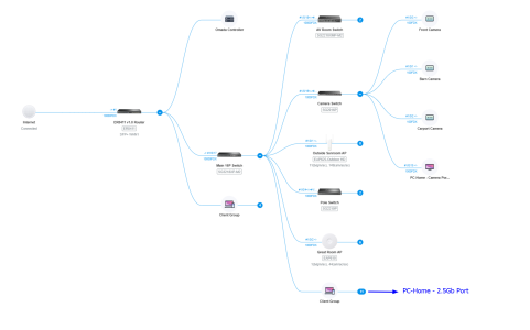

Yes... the 2.5Gb port on the PC is connected directly to the main switch via a single cable. Then, the 8-port camera switch is connected to that same main switch via a separate cable.
Here's what it looks like now. I can't expand the Client Group for the main switch because it makes the map too small to read, but here's the topology...
