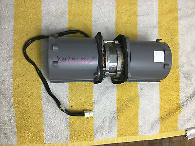

Specs, I found a pic of it on ebay, states the following the best I can tell from the LQ pic (attached).
OH SUNG FMOTE A517WRKZ
OBB-2249X1, 120V 60Hz 6.8uF
145/134/108W 1.23/1.12/0.91A
Note it's a PSC type motor. There are ways to speed control a PSC motor, but modding a mains AC component is not something that's a good first electronics project if you weren't already included to do that.
