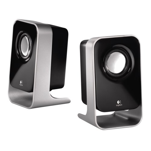

So I've now had two consecutive pairs of these speakers from Logitech:
Blow out on me and become completely funky... I'm no audio guy and I'm sure anyone reading this knows what speakers become like after something like that happens. They still produce sound but nothing tolerable, garbled and ear-assaulting.
Thing is, I actually very rarely use my PC speakers, typically I'm either using headphones, or pumping my PC sound through my TV's sound bar (TV is set as monitor 3 via a long HDMI to the other side of the room)
Even so, I do like to have the option.
I think the last 4 pair or so that I've had have eventually done this... though these Logitech ones did it faster than most, I believe. I think I'm paying for having gotten some very cheap ones, even though I think Logitech is a pretty solid brand and most of my input devices are from them etc.
These had no subwoofer, and I don't care about subwoofers... in fact it's better that I don't have one. I am not ruling one out... but I don't care about bass, at all, and it is just something likely to bother other people.
I liked these ones because of the flat sides allowing me to heavy duty velcro them to the side of my monitor.
Regardless... I'm looking for advice on some other speakers which won't blow out. Is such a thing even possible?
Prefer some which are only 2, and with no subwoofer.

It might be worth checking out Ben's suggestion since you've got 4 'blown' speaker sets. Then again your OP pic looks like a very low end model that is not going to last long when played at high volume.

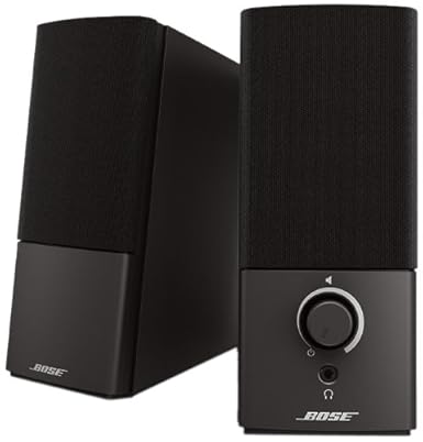

I ended up just going to Best Buy to see what they had, and walked out with these:
Bose Companion 2 Series
They seem good so far, and I got the 2 year replacement plan in case they blow out.
