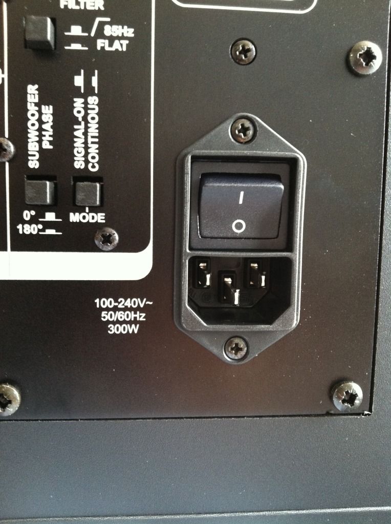

Alternatively, what about getting a 110 volt power cord from the speaker manufacturer? The back of the sub says it takes a 100v-240v power source:
http://i1191.photobucket.com/albums/z478/thm1223/AdamSub8PowerInput.jpg

You don't need to buy an expensive step down transformer. It looks to me like the Sub8 has a standard IEC C14 socket on it. The picture you provided of the back of the sub states that it can take an AC input of anywhere between 100-240V and either 50/60Hz. This means that US mains power (120V 60Hz) will work just fine.
So yeah, just grab a standard IEC C13 (for IEC, odd numbers are plugs, even numbers are receptacles) to NEMA 5-15P cord (aka your standard computer power cord) and you are set.

Awesome! You're actually right. I went ahead and plugged in the power cable currently being used by one of my A7Xs. When I flipped on the power switch the sub, it turned on without a hitch!
