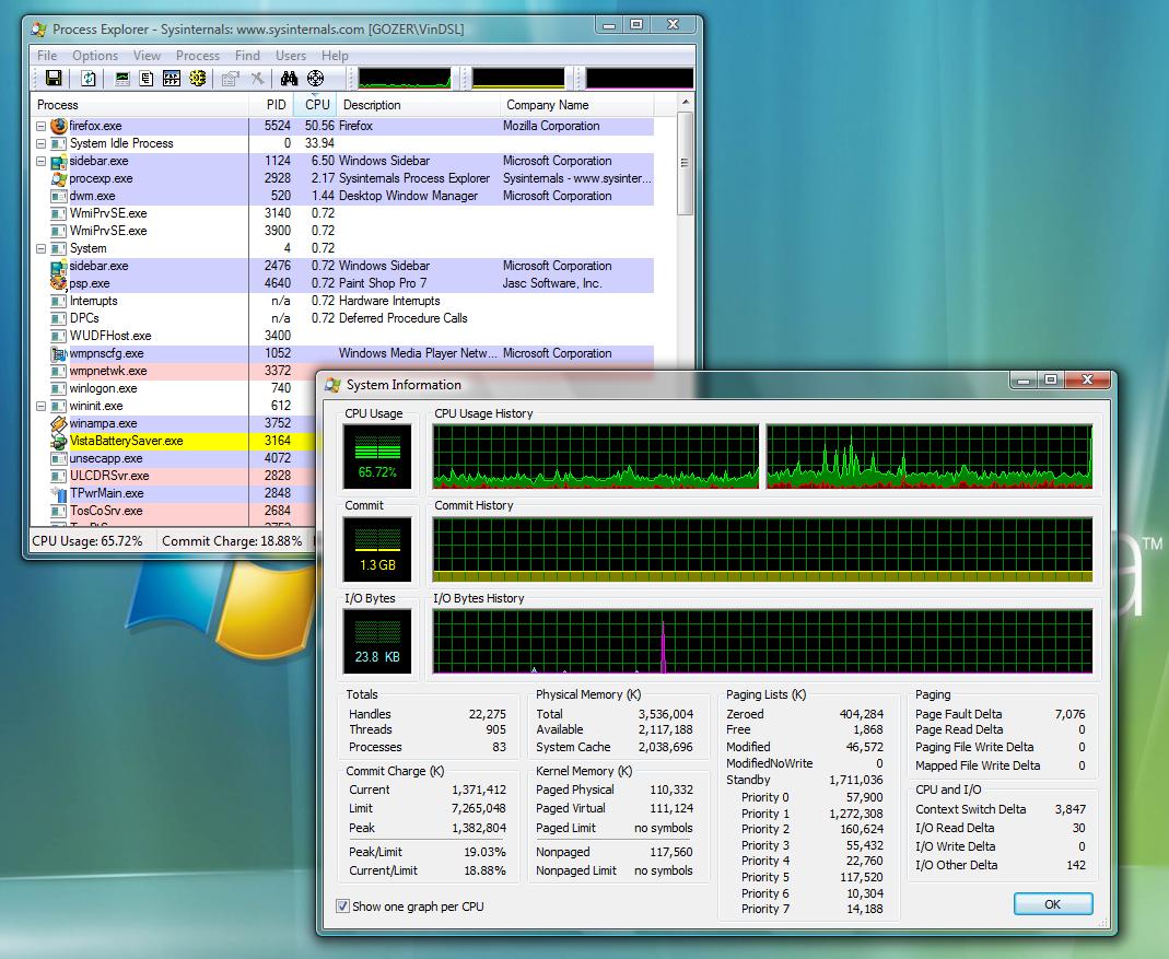

VinDSL
Apr 11, 2006
4,869
www.lenon.com
Originally posted by: basslover1
Ok, I think I found the problem. When I did the Windows update, it also had updated drivers for the card, turns out Windows is retarded, and installed the wrong drivers for the card.
Heh!
I (sort of) had the same problem with WU - it thought my lappy's ALPS touch pad was a Synaptics touch pad - still does.
It caused Vista to take about 5 minutes to boot up...
I finally had to 'hide' this update from WU, so it doesn't jack up my machine! ;)
