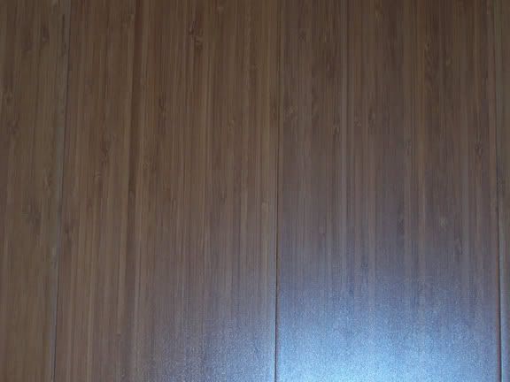

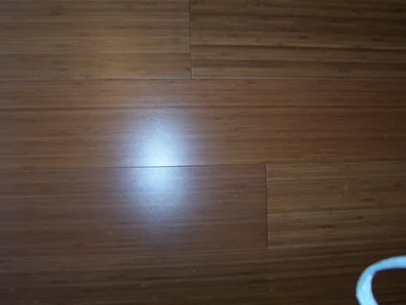

As requested by Sagalore:
Up close pictures.
Close1
Close1

The bamboo is tongue and groove. I am on a concrete slab so finding flooring that met my needs was tough. It was pretty much laminate, engineered hardwood, or this bamboo flooring. It was put down by glueing the tongue and groove with bruce's everseal floating floor glue.
It was a mess to put down and was very time consuming. You can get bamboo flooring that has locking tongue and grooves. If I had to do over, I probably would have gone that route because it was much easier. My issue was that it costs about $0.75/sqft more than what I got.
The only saving grace was that the boards were 6' long and 6" wide.
