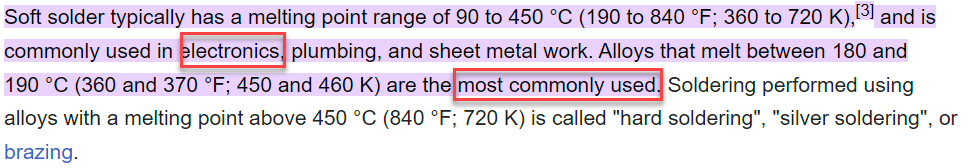

Hitting those higher temps puts more stress on the solder which will weaken with bigger swings between temps load/idle. I prefer a more stable temp than ultra cool temps. Theoretically though 100C shouldn't impact the solder though.
Erring on the side of caution the lowest temp to melt things would be 90C but, the highest point being 450C and average ~185C would indicate the potential for a shotty solder to come apart at the high temp watermark mentioned @ 110C. So, not knowing which method or metal/alloy being used with these devices makes it hard to know at which point there could be a failure or if we're hitting close to the melting point to cause issues after repeated heating sequences. If the excerpt is correct in that most devices are using a melting point closer to 185C then there's room for overheating with less chance of degradation.
