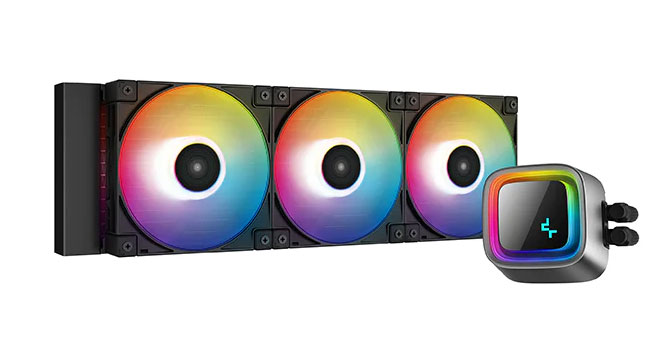

The MSI AIO isn't a good deal. They have quality control issues from what I hear. Better would be the Deepcool LS720.
