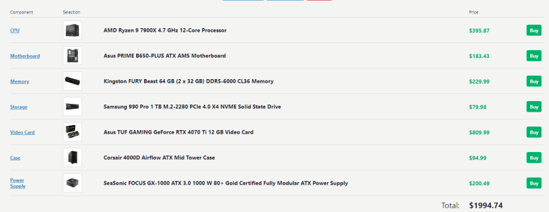

I tuned the specs using the recommendations here. I fits the $2000 limit.

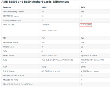

Now if I go with B650 chipset based motherboards instead of B650E, I may shave a bit more.
I'm not gonna use Gen5 SSD not, but later I may get one. I will get a Samsung 990 Pro this time. Do I really need B650E?
GPU will be 4070Ti or Radeon 79000 Xt , based on the price on Black Friday. Since I game a bit, and the monitor is 4K, this performance level is the lowest I should buy it seems.

Asus PRIME B650-PLUS, I guess fits my use case. And shaves like another $150.
I dont need Wifi or Bluetooth on the motherboard. Saves from unnecessary drivers too.
Seasonic Focus GX-1000 ATX 3.0, looks like a good choice for PSU. With these latest generation CPUS, GPUs is there a new feature that is required on the PSU? Will this do?
I paid $160 for an ASRock PG lightning x670e so, that price seems high. Mind you it was an Amazon return but works just fine.
I would take all of the parts you're thinking about and put them into PCPartpicker.com and see what works and doesn't and prices things out for the PSU. My go to is 850w for my builds and tend to stick around $100. While the new standards and cables tend to be closer to $150 last time I looked.
Thats exactly what I did. I prepared alternative lists and this is the one that stays below $2000 and it look ok to me. I may up the SSD to 2gb.
