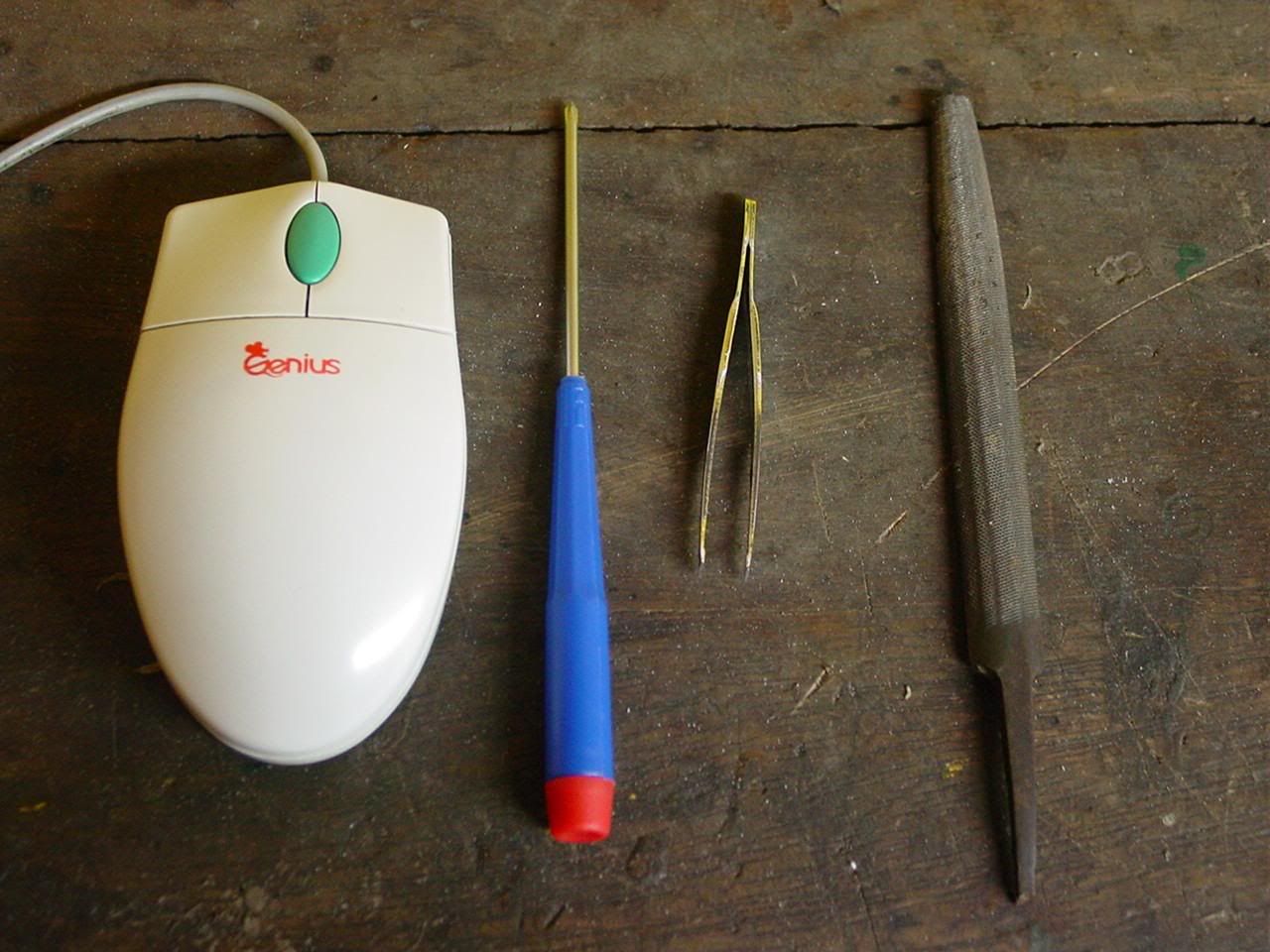

I was bored so I decided to do something just for the heck of it, I noticed my MX518 clicking noise is kinda annoying and loud, so I say to myself there has to be a way to stop that clicking sound so in order to keep my MX518 in mint condition I search through the bowels of my closet and find a PS/2 Ball mice from a LONG time ago to experiment on.

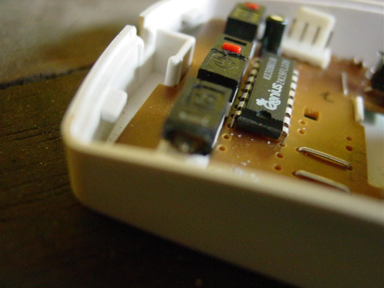

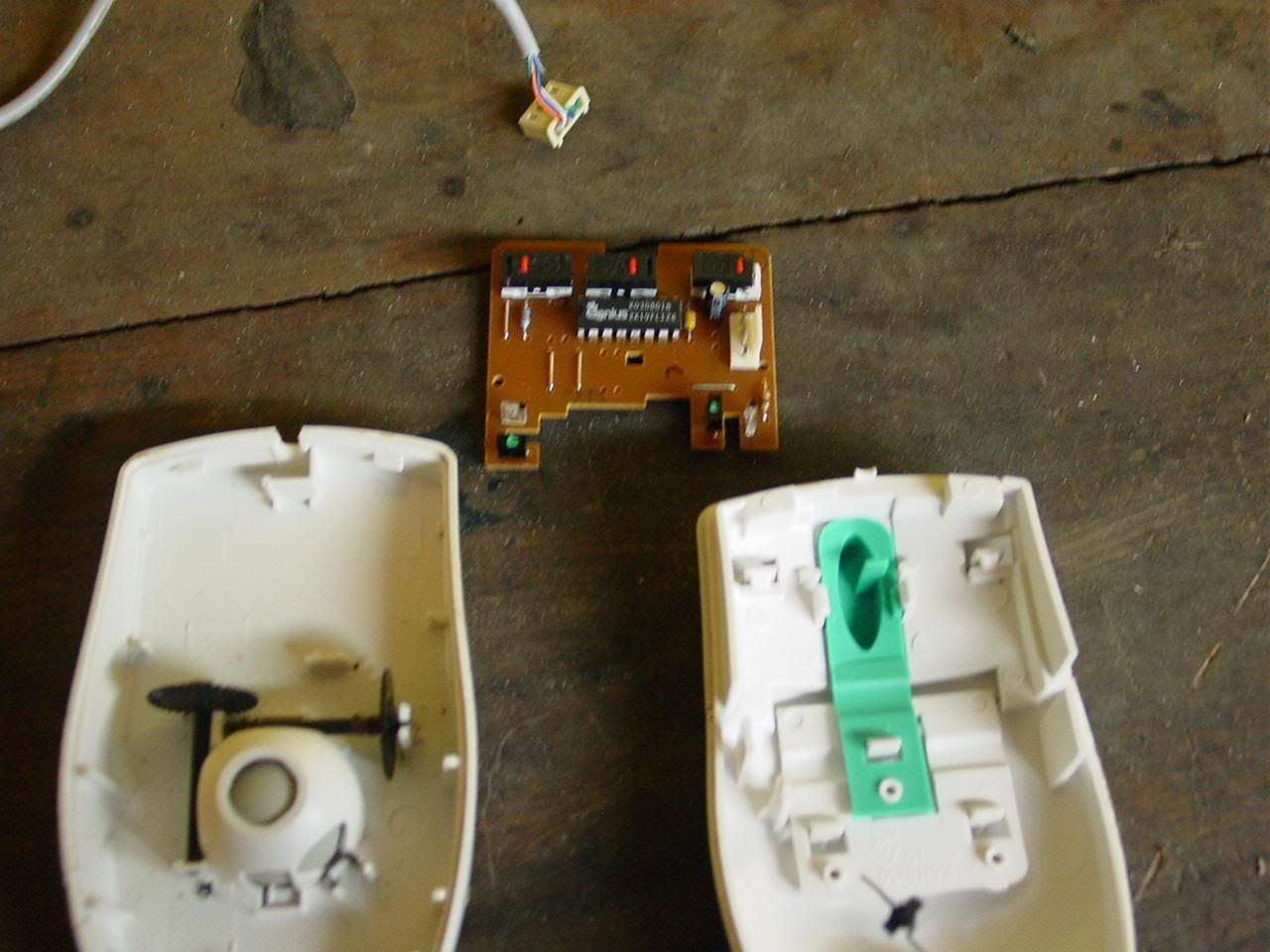

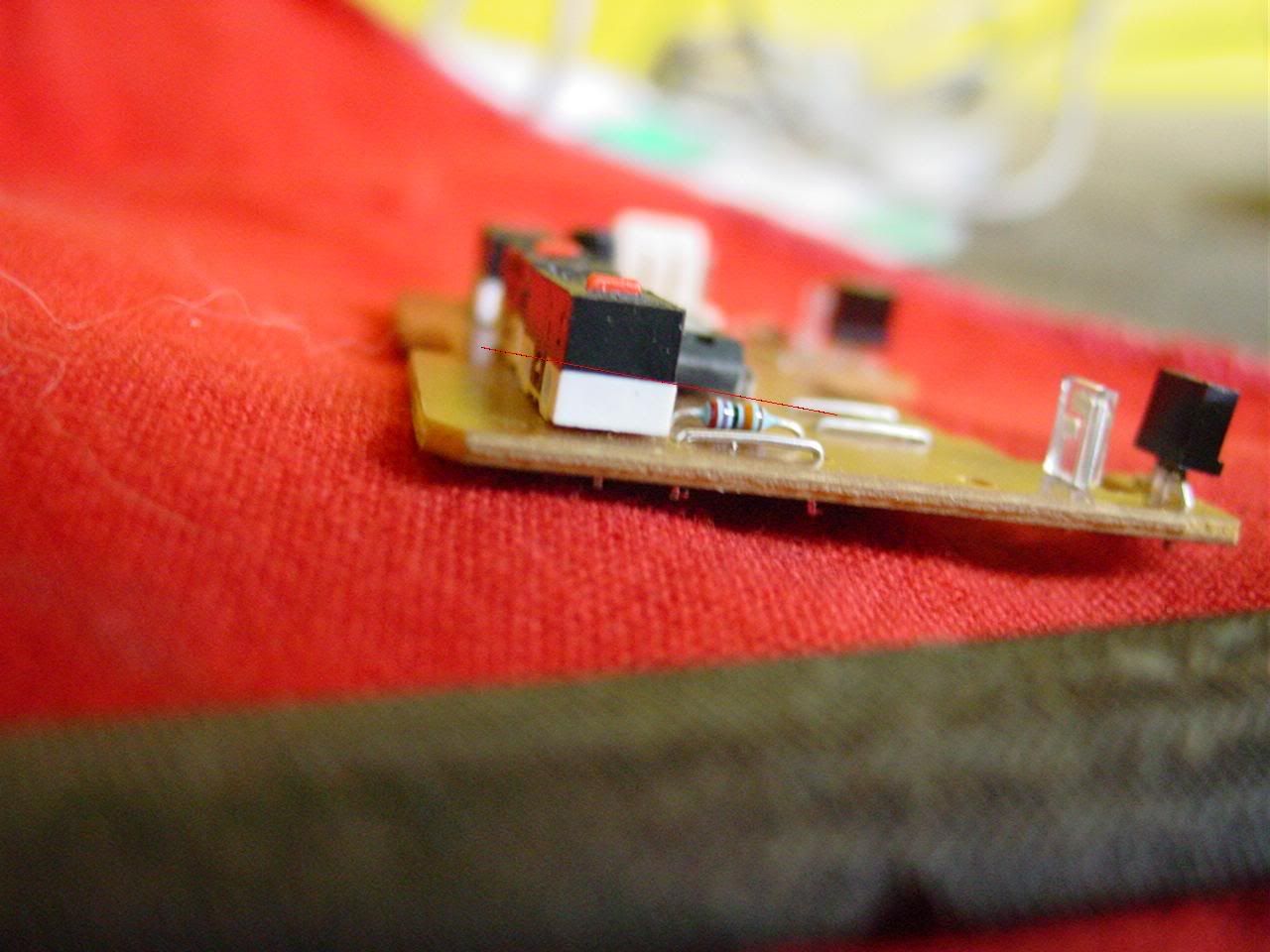

I open it up and notice the mouse button is a black plastic attached to a white plastic attached to the PCB, to the right of the black plastic a little red button is popping out, pressing it makes the clicking noise.

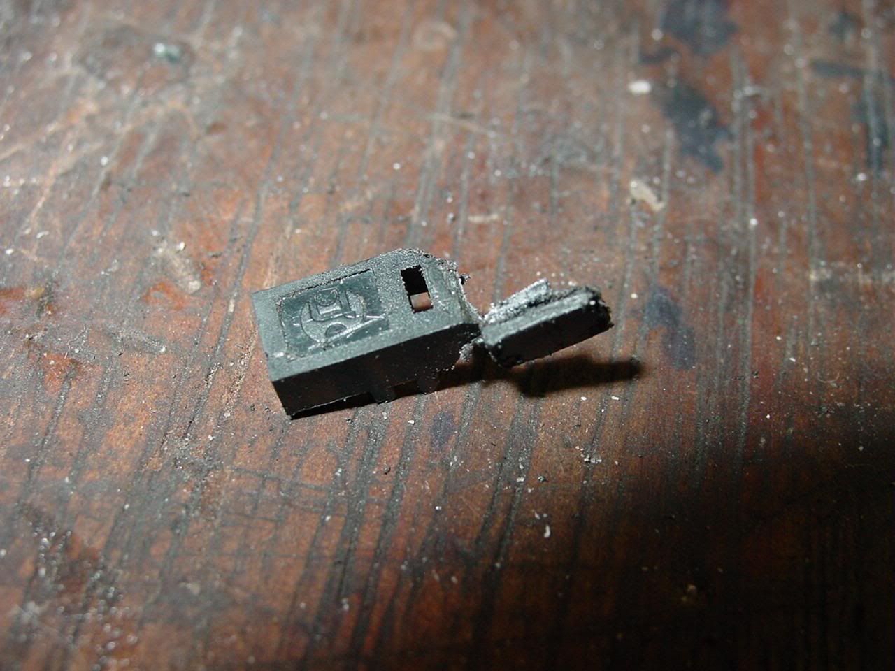

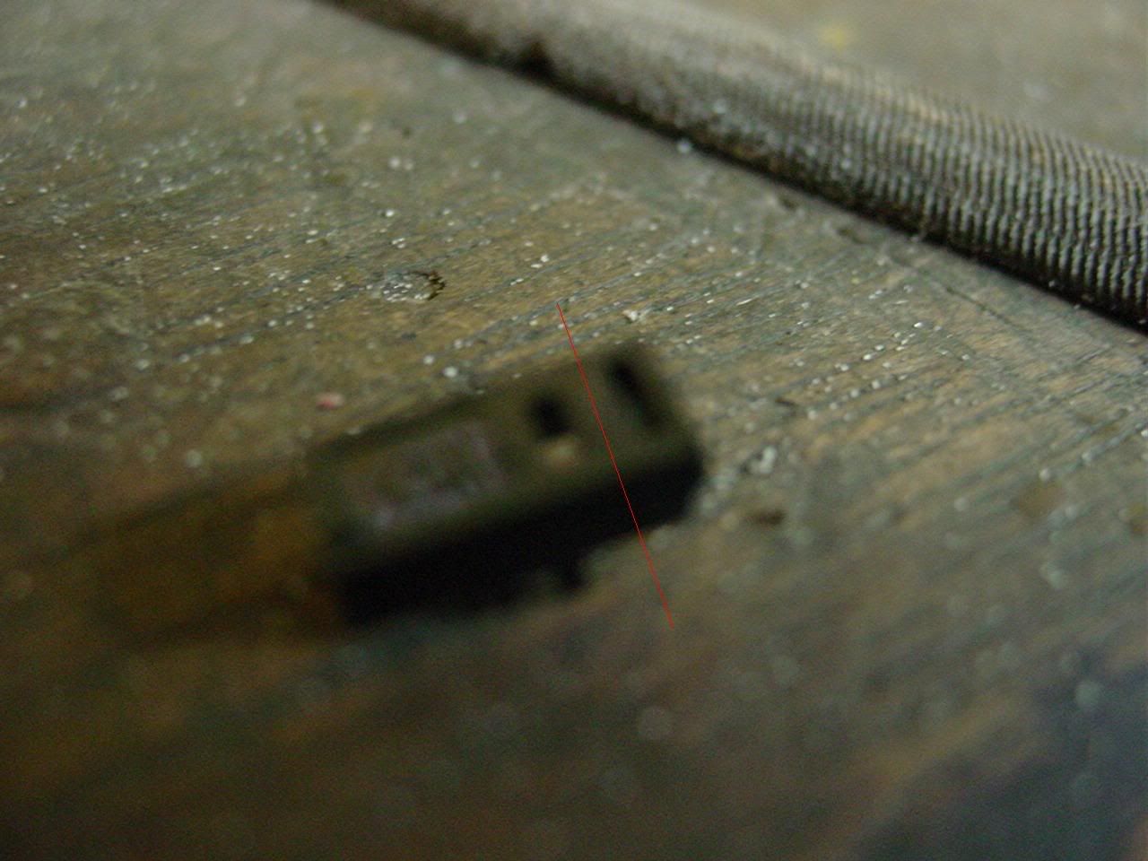

So, the black plastic must be removable I say to myself, due to the size of the ah heck it was impossible to do by hand or with any tools, so I get a metal lime, lime through the right side plastic just a little bit and use a tiny little clamp to pop the black plastic off. It turns out the button is nothing more than a metal making contact with another metal, the red button presses it in such a way it lowers the metal to have the button press effect but its also pops the metal in such a way it creates the clicking sound (sorry for the incredibly vague description and use of terms).

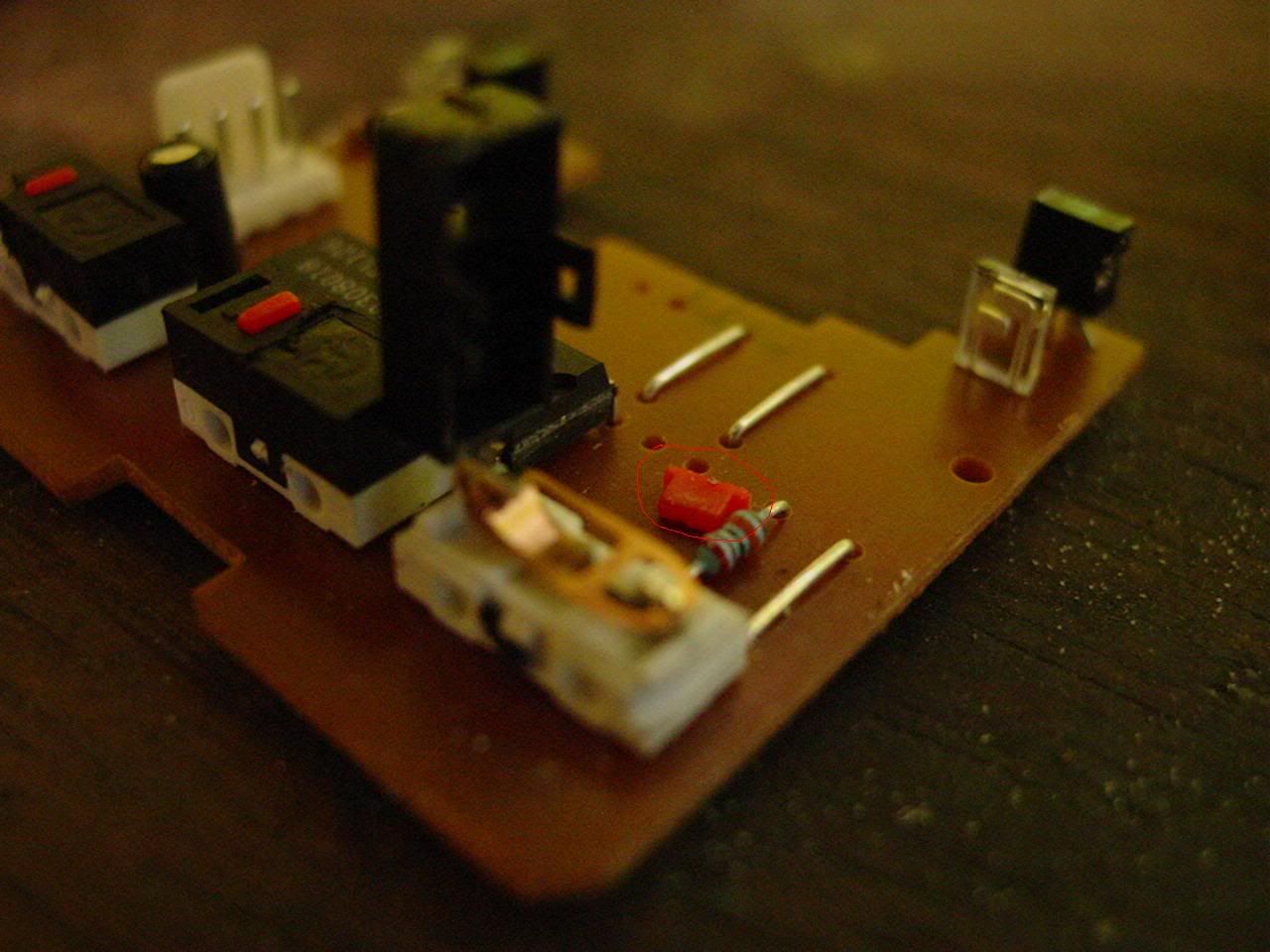

So anyway, I was able to remove the clicking noise entirely by using a metal lime on black plastic to cut off the right side and use a screwdriver to move the metal in such a way the button will still make it contact the metal on the bottom but not make the clicking sound. Well, at first I thought I had effectively damaged the entire button (it was the right button mind you) but then I connect the mouse and voila!, now I have a fully functional mouse with a silent right mouse button, its not completely silent but compared to the other button its like night & day.
