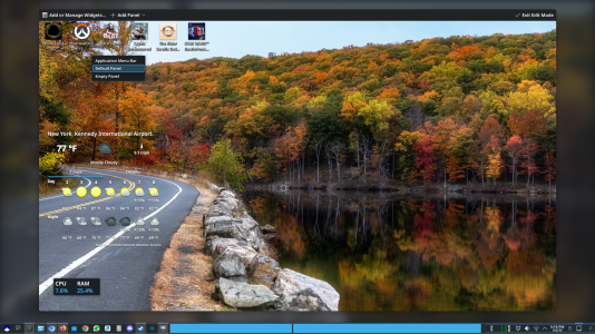

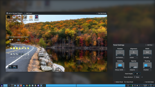

Ok I'm not doing this to change your mind or get you to switch.. but if you ever experiment with KDE again.. this is the quick 5 second fix to that:
1. Right click on that empty taskbar that you have left at the bottom
2. Click on Show Panel configuration
That'll make KDE look like this:
3. At the very top where it says Add Panel.. click on that and select DEFAULT PANEL
And viola.. that's it.. you got your standard task bar with icons and launcher and everything back to default.
It won't fix everything like go back to how you had it configured but it goes back to the way it was when KDE launched into the system first time and you can reconfigure it again how you like it.
