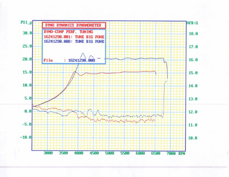

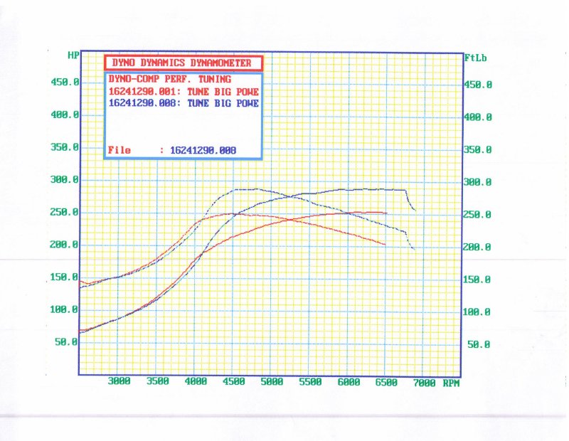

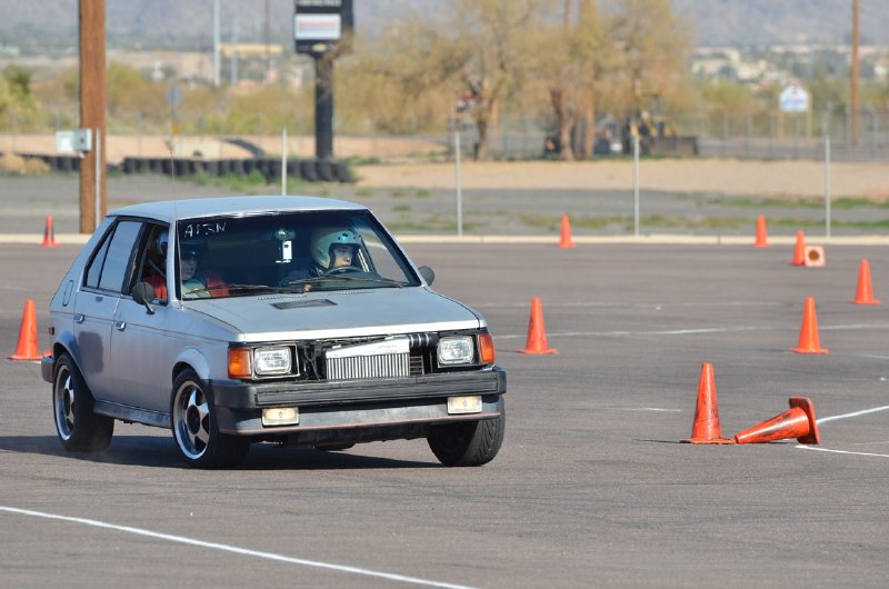

My GLH made 290whp.
HarryLui
Aug 31, 2001
1,509
31
Modification? Plenty.
Ported 8 valves 2.2L
I'm really happy with the torque and power curve.
Baseline run was 15psi, in red.
Power run was 20-21psi, in blue. Added couple more degree timing, pulled some fuel out and added 4-5 psi.

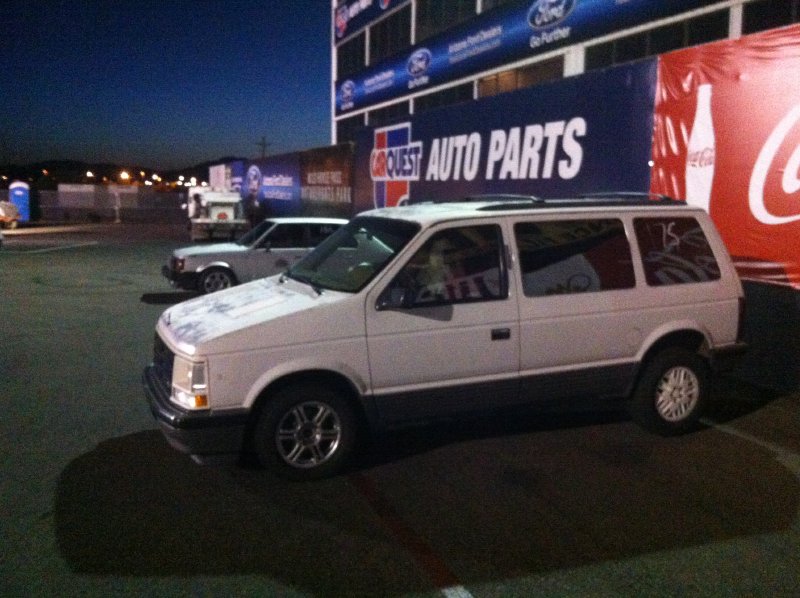

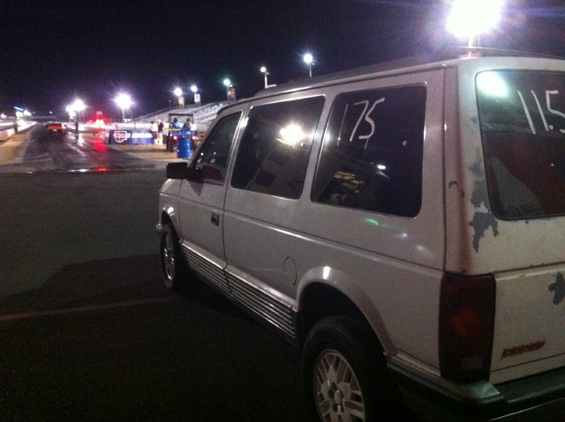

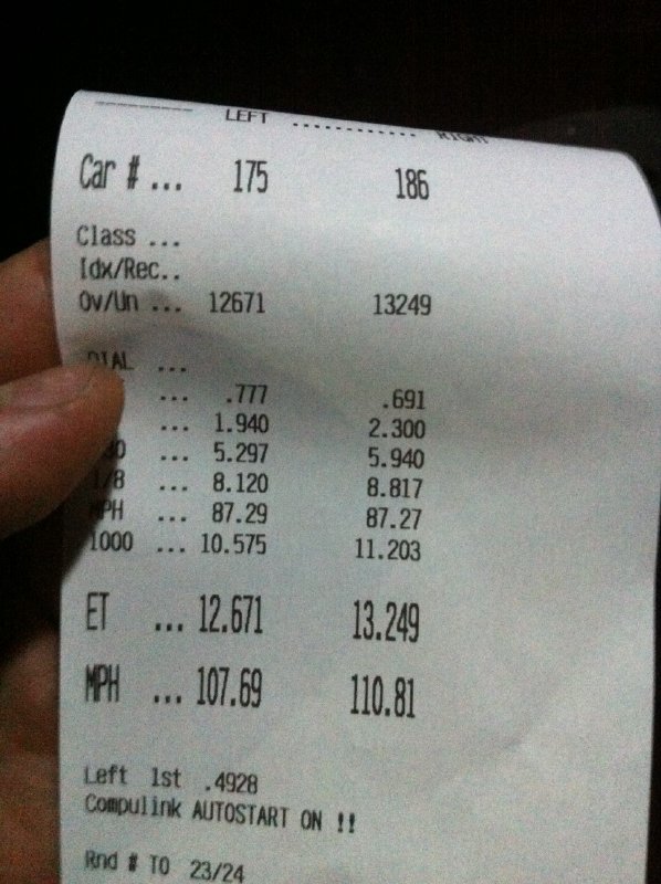

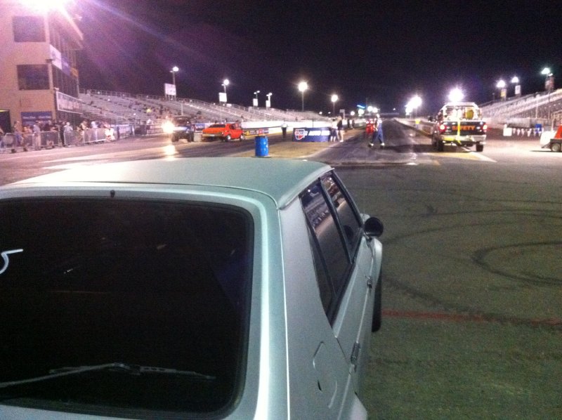

Reached my goal of 110mph of trap speed.
Now, if I can drive better, I'd have a mid 12 second car.
HarryLui
Aug 31, 2001
1,509
31
Hooking up has got to be tricky - what tires are you running?
225-50-15 BFG DR
To be honest, I'm more interested to see what the car can do (trap speed), than what I can do (time). Also, to get over 110mph, I'd have to shift to 4th gear using the 225-50-15 tires.

How did the Turbo Van do?
Very nice #s/car. I don't care what anyone says those things are awesome.
Easily mid 12's, should be able to get into the 1.8xx range on 60' with enough traction. I'm pushing a heavy 96' Thunderbird (3850#) to high 12's at 105mph with only 299 rwhp by cutting 1.86 60's. Still waiting on my stock long block 3.8L V6 to die but she had held up to 10-11psi from a Vortech for 60,000+ miles now.
