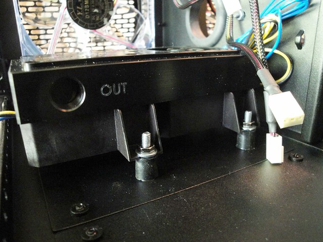

A little more work today. Cried a few big man-tears and picked up the drill and slowly pointed it towards my $400 baby.
Pumps are mounted and the Iandh clamps are in. The clamps look a bit crooked in the pic, but that's because I drilled holes with a little wiggle room to make adjustments. They probably just shook a little loose moving the case around as I haven't tightened them down yet.
Forgive the dirty case. It got a lil dusty during the work today.
The soft bay mounts for the EK top worked pretty well to mount the DDC's. Pretty happy with how everything turned out :)

mmmmm.... can i see the underside of that top where it shows the gap between your pumps?

Won't bolting the pumps to the bottom of the case cause quite a bit of vibration and noise?
Interitus
Jan 28, 2004
2,143
9
Aigo,
pic might have to wait till tomorrow.. terrible weather here and I'm just using the last of the battery in the laptop.
Those mounts don't have screws that go all the way through them. It may appear like it, but the screw that goes into the bottom is completely decoupled from the screw that holds down the pumps.

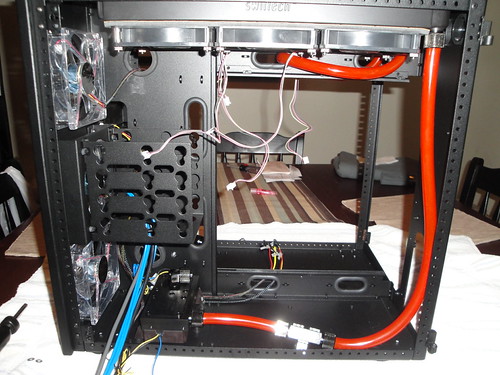

Got back to work today after the GF's computer is back up and running.
Nothing worth taking pictures of, just test fitted the radiators with the spacers and then rinsed out the rads with boiling water and distilled. Also got a feel for how I was going to route the tube between the two rads. Looks like 45's will work perfectly. Starting to feel like I should've ordered more 45's, lol. Originally ordered 5 45's and 5 90's when I was planning on stuffing all of this into an 800D. Curse you once more Caselabs! :p

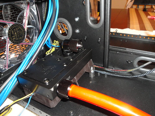

Well the good news (I guess.. sigh) is that the 45's to connect the two rads didn't work out. I ran the tubing for the rad connection and the pump to PSU side rad just now and it just wouldn't work out. So I wound up having to run the tubes from straight compressions in a big arc through the next hole available in the case. Not what I wanted but oh well. Now I'll have more 45's to play with later.
I really can't figure out what to do about the res and how to connect it to the pump. The easiest and purdy-est way would be to put a 90 on both the res and the pump. I don't like that at all.
I took pics but the camera battery was dying so they turned out total crap. I'll take some more later and post them up.

Also, a few of my 45's and 90's have a pretty large "rock" in them. The two separate areas at the swivel point lean back and forth quite a bit. Is this normal?
WoodButcher
Mar 10, 2001
2,158
2 years? two builds more likely. Been longer than that T. I've got shelves,,,,, 2 foot deep 6 foot long with PC crap and my LC boxes are plastic totes 24' x 16" x 6" deep, 3 of those totes,,,,,, pumps, tops, fittings, brackets, blocks, reservoirs, you name it, it's in there. All but the rads, they got their own box.:whiste: I think if I got all my fittings in one place I could fill 1/2 of one of those totes and I know damn well you've got more scrap than me.:p

I really didn't want to have to run the tube like that, but looks like that's the only option. Same with the rad to rad tube :( I'm sure about $50 more in fittings could fix the rad problem though, lol. Probably something I'll do down the road.
Will finish up the case tubing tomorrow and then start pulling parts from the current rig to get blocks mounted.
