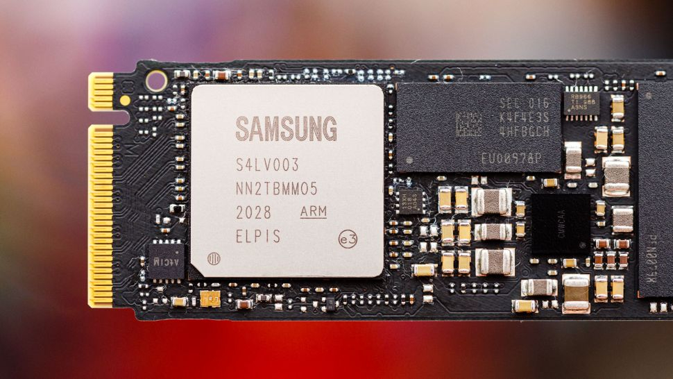

Samsung SSD 980 PRO 1TB (Windows 10 install, from a USB drives using microsoft's installer)

I assume you are using a UEFI install of WIndows 10? If so, the OS should show up as Windows boot manager, on the 980 Pro. Make sure that it is trying to boot into UEFI mode. It is also possible that this issue could be related to flaky power, either from CMOS battery, or possibly PSU, since you mentioned a full power off and sitting would sometimes allow it to boot again later. And of course it could just be the motherboard, as you suspected.
