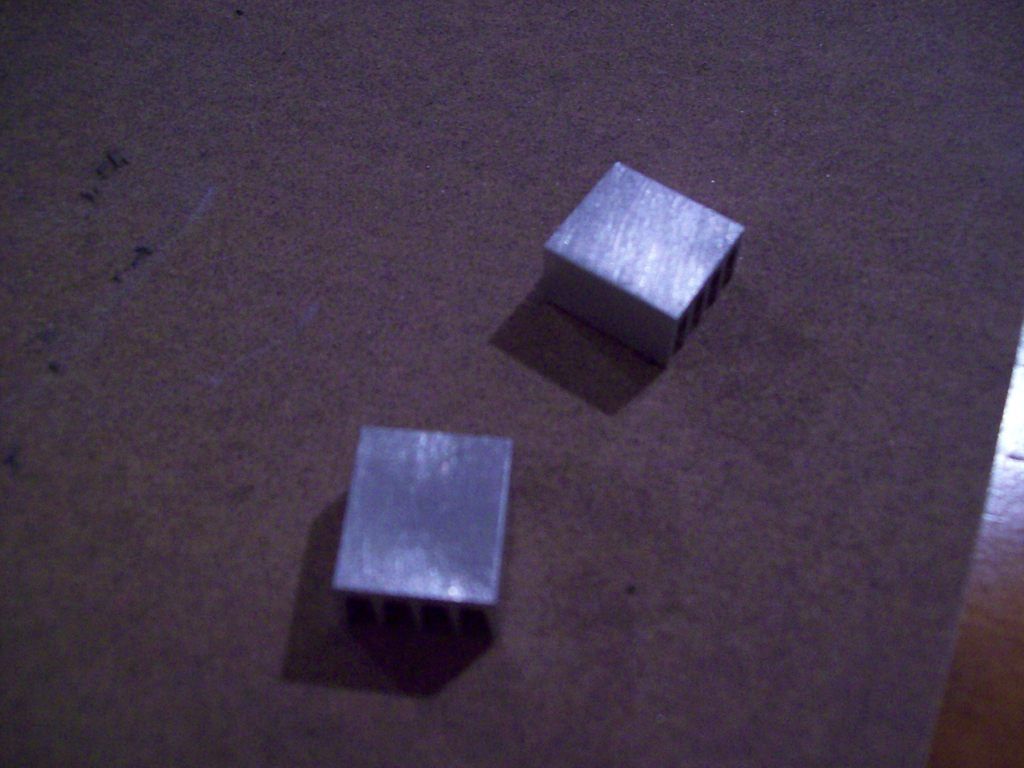

Materials List:
1) ZEROtherm ZH100 Heatsink Package - Pictured Here
Available on Newegg.com
2) Arctic Cooling Accelero S1, rev. 2 VGA Cooler
Another Newegg.com Link
3) Arctic Alumina Epoxy
Yet another Link to Newegg.com
4) Misc - Fine grit sandpaper, something to mix the epoxy on, Arctic Silver for the GPU core, and some precision screwdrivers.

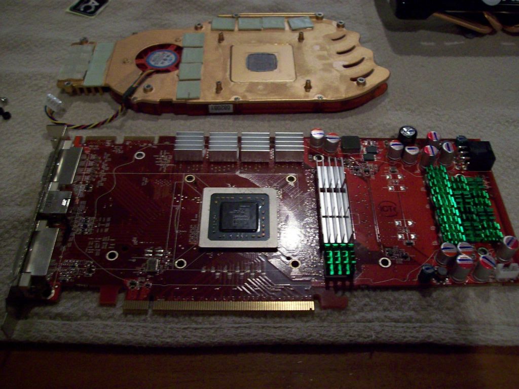

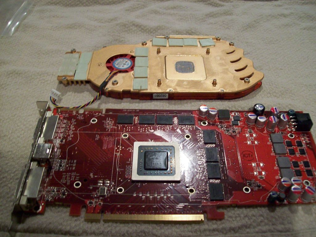

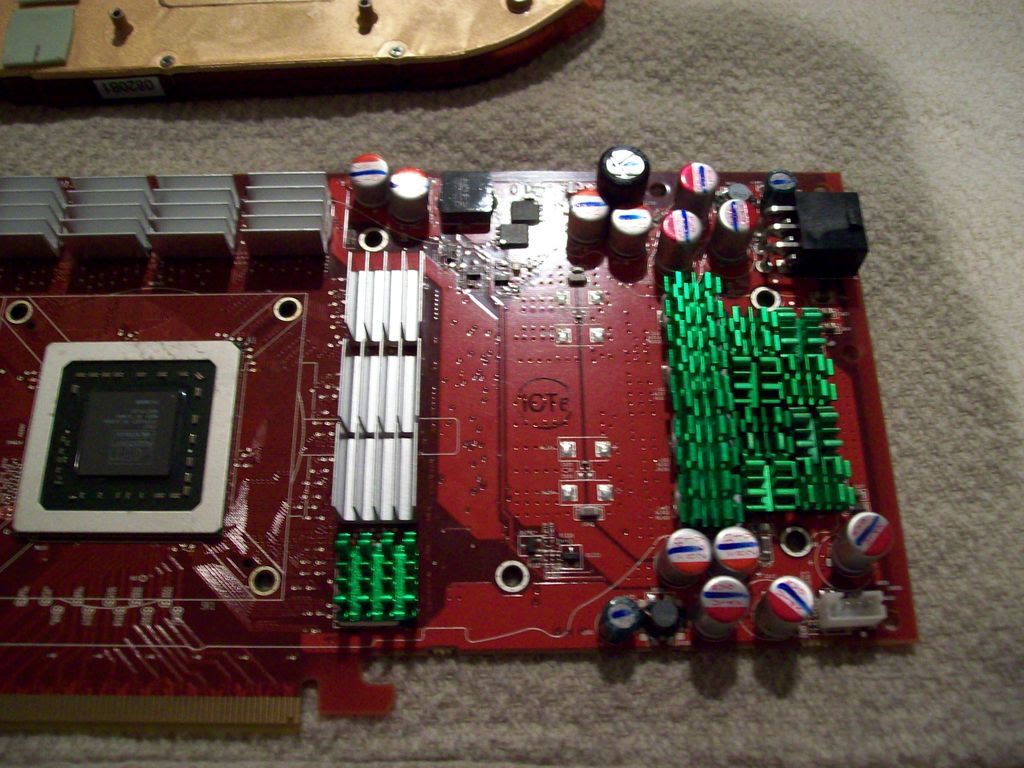

Ok, I like permanence and good heatsink contact for my video cards. I just don't like the thought of pieces of metal coming loose and bouncing around my case. Hence, I removed the sticky stuff from my Accelero heatsinks with sandpaper and throughly washed them with water to removed any metal residue. I also removed the adhesive from the ZEROtherm heatsinks to ensure great contact. I chose Arctic Alumina Epoxy to secure everything since it is non-conductive and it works nearly as well as the Silver equivalent.
Warning: Explicit naked pic of a Visiontek HD 4850!

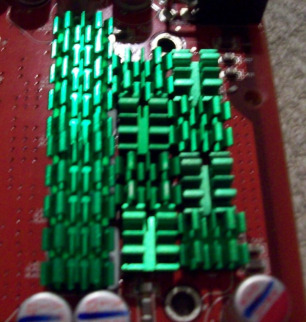

VRM heatsink layout close up.
Finished epoxying everything to the board.

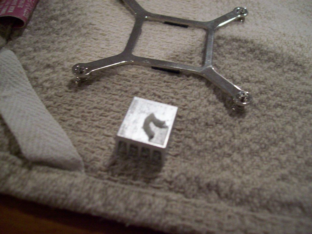

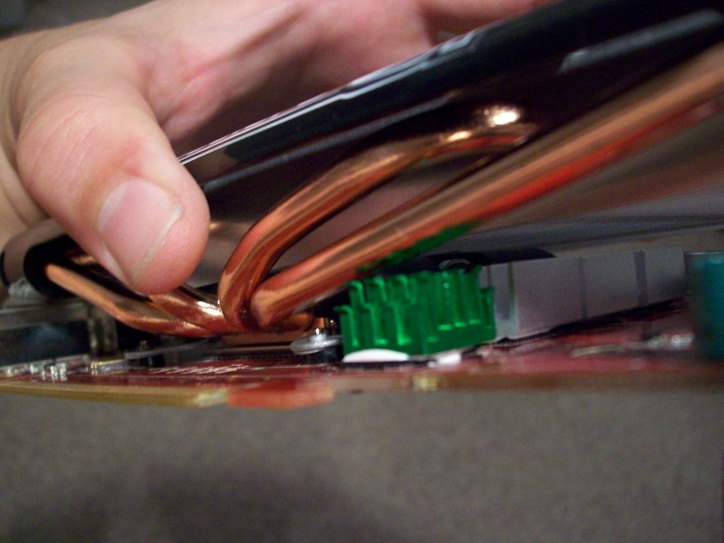

I used the single green RAM heatsink because the Accelero heatsink is too tall to properly mount the main GPU heatsink, due to heatpipe clearance. I had to basically line the left edge of the RAM chip with the left edge of the green ZEROtherm heatsink (in the orientation shown here) to make it fit, and boy is it a tight fit. I let the finished board sit for 15 min after using epoxy to secure all the heatsinks. Since the epoxy takes around 5min to set up, I installed the VRM heatsinks first, made up a fresh batch of epoxy, and then did the RAM sinks. You need to be well prepared and quick to get everything looking nice, and I think I did a reasonable job of getting everything straight and looking good.

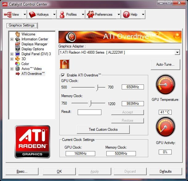

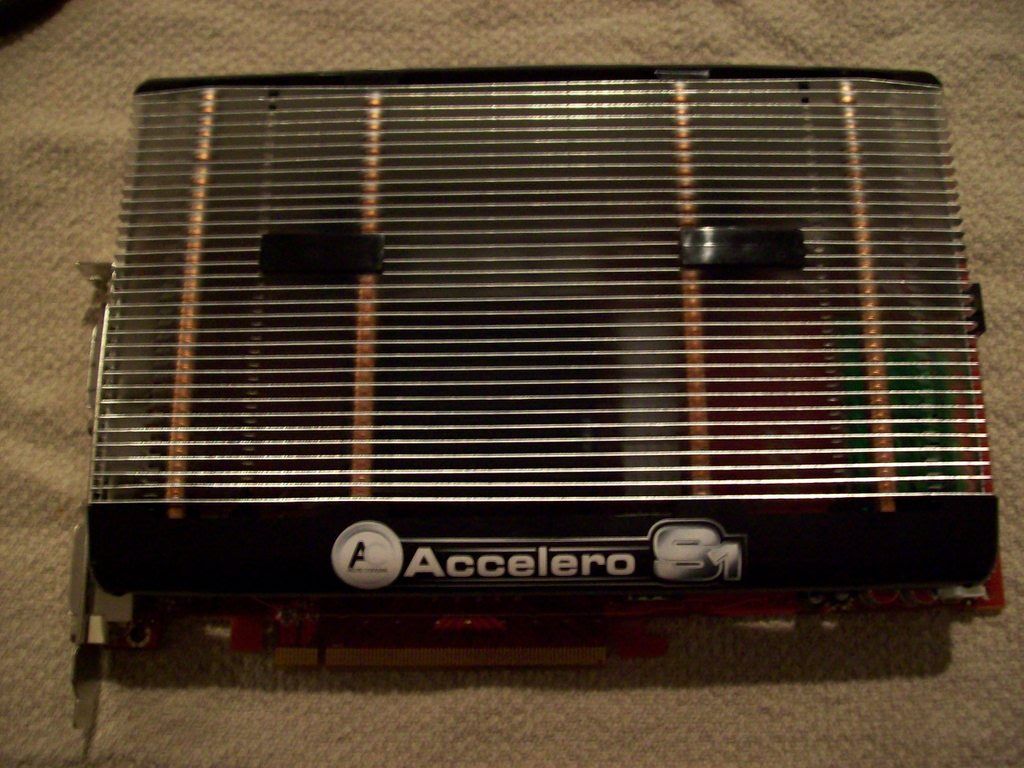

Now all that's left is to put the GPU heatsink on. This is fairly straightforward (Arctic Silver 5, line up spacers and screws provided in the Accelero package, and tighten everything down), so here is the result of my labors.
My case uses all silent fans, so my airflow is good but not exceptional. I get 40-42°C idle temps and I have yet to crack 55°C under full, long-term gaming load. Passive and powerful, which are rarely combined words when it comes to high-end video cards.

You left a couple of chips uncovered. http://img113.imageshack.us/my.php?image=11fo8jw1.jpg
The reference cooler doesn't cover these either and many people think that's a fault in the design. Did you even consider putting sinks on them?
Scoop:
I didn't do this either!!! But I can. And will, especially if I should. As it is there was another post on another site that mentioned the ill effect heat can have on the two tiny exposed chips on the reverse side. I chalked that up to over-reaction on the part of the poster, but I have read second-hand posts, here and there that say the early 4850/Accelero modders were frying their boards and that the original heatsink is necessary. However, this was never confirmed in any review where the mod was done and never confirmed by anyone who it supposedly happened to.
So if you have any details/data regarding any ill effects caused by lack of a heatsink on those two chips, or the smaller chips on the reverse side of the 4850, please post back and let me know where I can follow-up so I can remedy things now. I'd hate to have what I think is the perfect solution only to end up with a fried board.
Thanks in advance. Again, all the negative about this mod I have read relates to either users who think we're silly to care about heat or second-hand posts with urban-myth type stories of how it won't work, although I can't see how it wouldn't, especially when used with the Arctic Turbo silent fans (or any other fan, silent or not) as backup. I mean, seriously, there is very little air cooling left to do once you are already at 35C.
Still, any feedback you have would be appreciated! At the very least, it seems simple enough, even if just as a precaution.
