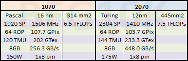

I like mini cards. They offer fantastic performance in a very small footprint. Unfortunately while the 1070 was pretty quiet, the 2070 sounds like a vacuum cleaner in comparison. I don’t think this style of form factor can cope with a hot Turing chip.
Aside from the huge memory bandwidth advantage, the 2070’s other specs are mediocre relative to the 1070. But we’ll see how the cards compare in real benchmarks.
