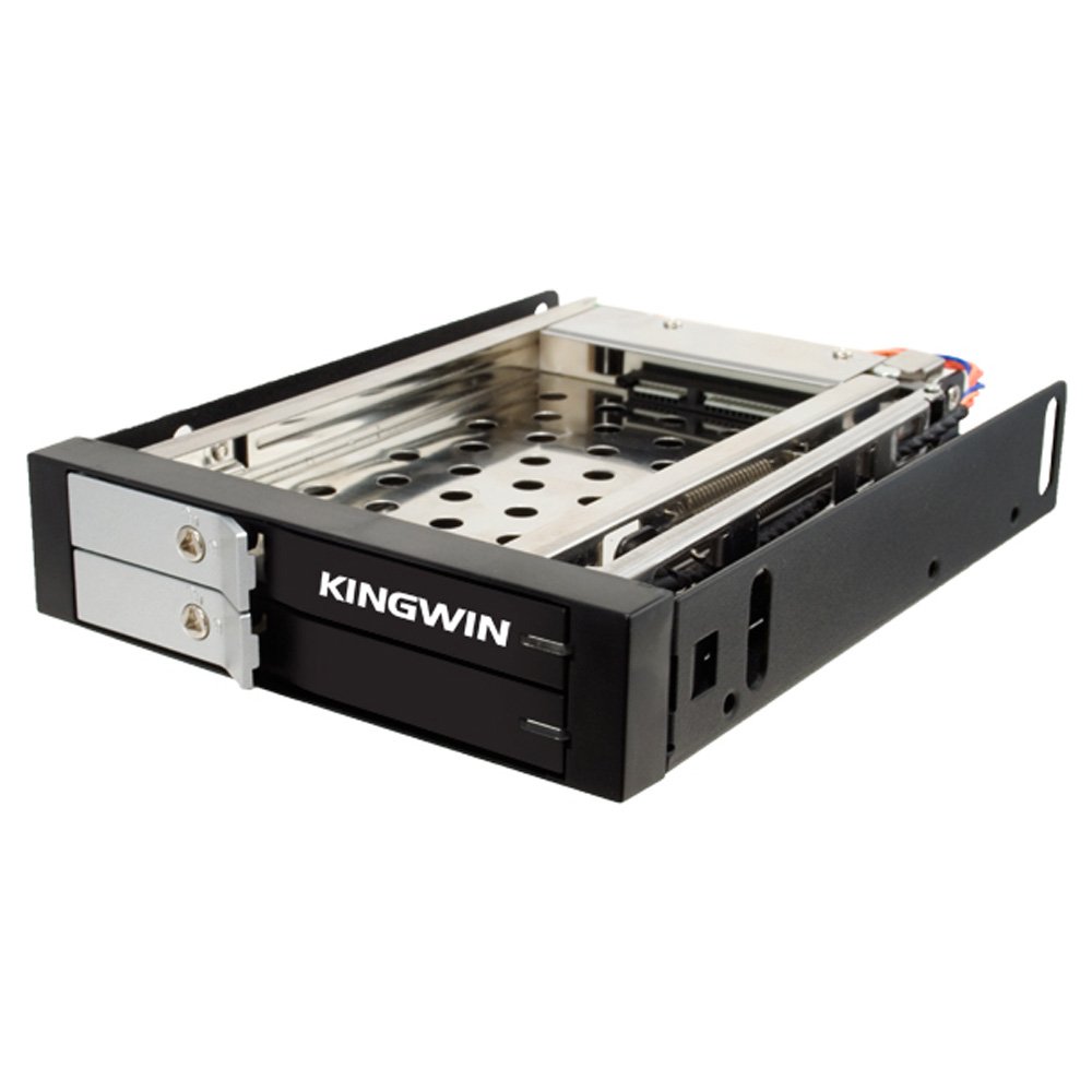

fwiw, on the subject of unpowered SSD storage
i've been using one of these for a few years now, for that very purpose
one of the bays is powered + the data cable is connected, the other is only powered, with no data connection
I'll clone the OS drive, and then move the SSD to the bay w/o data connection. Meantime, i'll move the SSD that i cloned the previous week into the bay with both power & data connections, kind of leap frogging my backup clones. But the idea is the SSD stays powered, no matter which bay it's in. And in the event of a massive failure, ie data corrupted thru malware infection, or maybe a bad cloning, i've always got the 2nd SSD that might be 2 weeks old, still secure.

i was showing you how i keep my SSDs from loosing data over time due to lack of power, which SSDs will do
