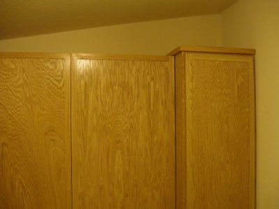

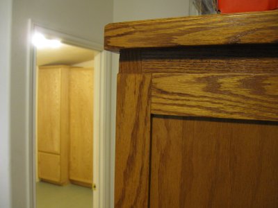

Found some. I was copying this armoire style but not the gagmeee golden oak stain. I call it "faker" for fake shaker. You can see it in place behind. Eventually that piece was moved in there.
I built the side cabs to take the load and fill the space, craftsman style.
It was all built with the same method of red oak veneer plywood

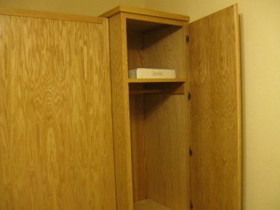

with trim pieces of oak that I sawed and planed down, and applied with glue and clamps.

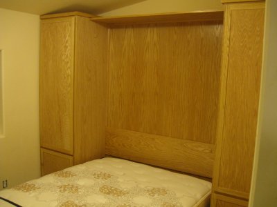

I made the face of it in two pieces as I had no access to 64" wide ply, and trimmed it as if it were a pair of doors sans pulls.

My go-to finish is a floor finishing product. https://www.acehardware.com/departm...5VCLxqiVGPQ0JyVMoMhoCKs8QAvD_BwE&gclsrc=aw.ds
It is water based and odorless, easy to shoot with a cheap HVLP hopper gun from harbor frieght or whatever. In the summer I can knock on several coats and sand between them in a day. It dries fast and very durable.
