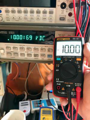

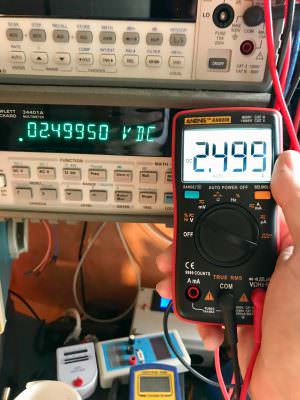

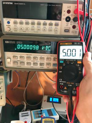

And it shows in the measurements, we have a lot of fluke multimeters at work, some cost around 500dollars / euros.
Like the fluke 87 V. We did a nanoampere test and the AN8008 has exactly the same results down to 100nA as the fluke. On another test, i noticed the AN8008 would still measure 45nA of current in a test setup. Lower than the fluke 87 V can show because the resolution does not go lower than 100nA for the fluke.
