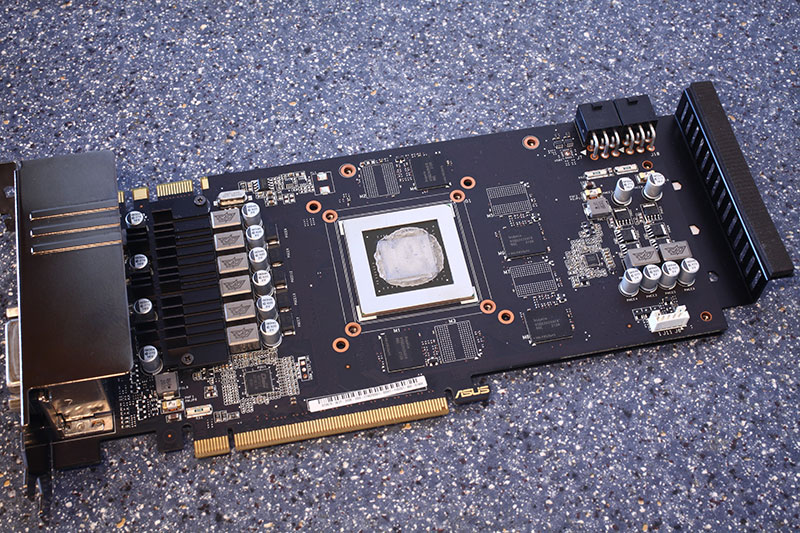

I'm considering the non-top version. This picture is of the top version that shows most of the vrm covered.

As far as overclocking goes, it's definitely an issue that the DC II cards have naked VRAM chips with no kind of heatsink/unisink touching them, as well as that small black heatsink covering the VRM's. The VRAM IC's get pretty warm, I measured them around 80C at the surface. That is without the DC II heatsink on because I have a universal block on the GPU. I'm not sure if the fans of the DC II cooler itself provide adequate cooling by the air that flows through the heatsink, which is already warmed. The VRM bank on my DC II 680 is a set of 10 phases all dumping their heat into this tiny sink. 100C is easily attained even with a tiny over volt. Yes they're rated to withstand that, but so what. No thanks. I strapped a fan to that area (not sure about getting a full cover block) and haven't seen VRM temps over 60C since.
I like the DC II and everything, but if I was shopping for a 670, it'd be an MSI Power Edition, no question. I've had two Twin Frozr cards, and thermally they were great performers overvolted and overclocked.
