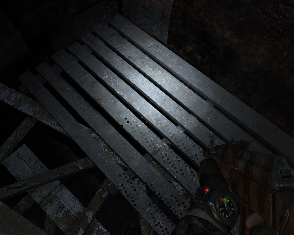

OK, so I have a few pics and a little update after some thorough testing.
This is what I get in Metro 2033, Skyrim, Fallout NV and Borderlands 2:
http://i1328.photobucket.com/albums/w532/Tanuki13/Borderlands22014-01-0113-53-50-56_zps1d1ac8ba.png
http://i1328.photobucket.com/albums/w532/Tanuki13/FalloutNV2013-12-3117-49-25-57_zps78a55dcd.png
http://i1328.photobucket.com/albums/w532/Tanuki13/TESV2013-12-3117-41-19-86_zps6a9f298c.png
http://i1328.photobucket.com/albums/w532/Tanuki13/Metro20332014-01-0101-08-50-20_zpsd1b7c28c.png
The glitch is frequent enough to easily capture those screenshots with fraps, flashing every few seconds.
GPU temp hovers around 45 and peaks at 50 C. GPU usage is between 50-90 % at all games (usually hovering around 70% and spiking at 90%)
Core clock is fixed at 900MHz under load and 300MHz idle while Memory clock is 1200MHz load and 150MHz idle.
The artifacts appear on both monitors (my 1280x1024 BenQ and also the big HD TV downstairs at 1920x1080)
I am inclined to RMA the card tomorrow or the day after, I just want to exhaust the possibility that this might be some other hardware-related fault which I have yet not discovered (I would be really miserable If I get a replacement 7850 or If I buy a 7870 with the refund money and still have the same problems). Before packing the box to send the card back I will try the other PCI slot on the mobo. I don't want to flash the BIOS and risk frying up things, my ASUS H87 is brand new, I think newer than the GPU, and the whole computer worked fine with the previous 6670 card. RAM should be ok too.
I have tried catalyst 13.1, 13.12, and 12.6 with the same results. One interesting thing is that fallout, when auto-detecting specs, sets the game setting to medium quality, which I find hilarious but leads me to believe that the card is indeed the culprit. Needless to say that I could play at ultra high with the 6670.
For powering the card I am using the pci-e extension from the PSU not the double molex to 6-pin that came with the card and judging from my devices i shouldnt be using more than 350-375 W at highest loads.
Once again any thoughts, suggestions or expertise would be greatly appreciated.
